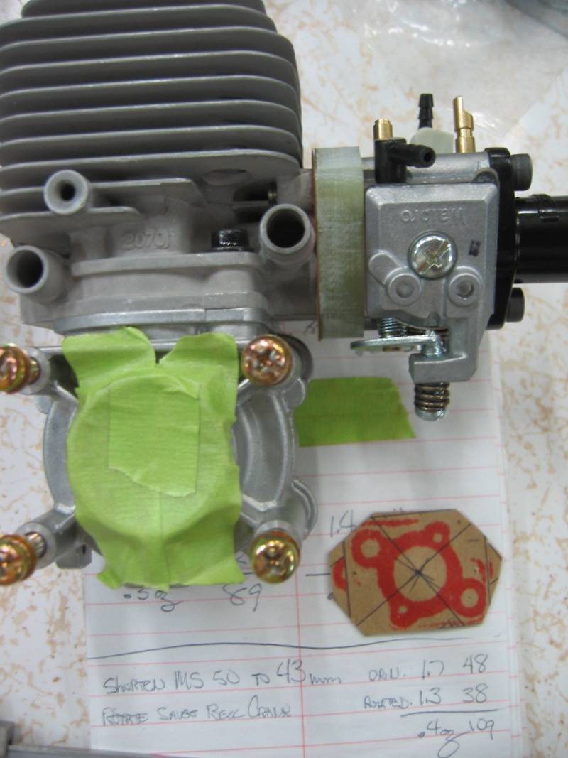

There is a .6 oz. weight savings compared to factory supplied insulator.
I opted not to bother with routing a pulse port thru the insulator. Last one I drilled to midway 3/16"on beraing surfaces and then drilled intersecting holes from the sides and then tapped the holes and inserted small setscrews with sealant.
Is there a preferred location to drill and tap the case for a pulse fitting, like the type used on glow mufflers?

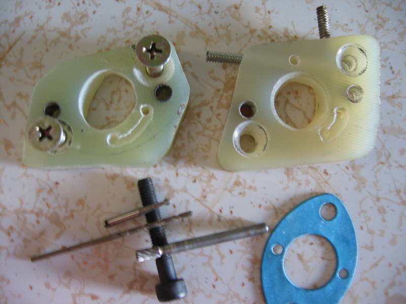

Rotate the carb 180 degrees, drill the G10 through to the pulse hole in the cylinder...Put the carb gasket on the G10, mark the pulse location that's now at the back...drill a 3/32 hole about 1/8 deep at that localtion..connect to the through hole with a 1/16 wide passageway about 1/16 deep...There's enough room if you don't make the passage too wide..All mine are made that way, saves making intersection holes, takes only a few minutes with a Dremel and a 1/16 ball tood....Go slow, it tends to wander....

A few cautions in making the rotated insulator. There is probably a reason the manufacture made the carb bore and the intake port just a little undersized to the opening. It was not because they had extra material to waste on sloppy engineering. Luckily one side had sufficient meat clearance. to allow a direct thru hole 3/32". The worm hole is a one slow pass. I used an old 1/16" round dentist burr depth set to cut its maximum width.
The second insulator with different engine mount dimension depicts other pit falls. No CE stuff here!

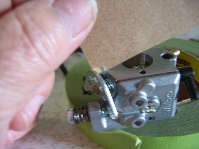

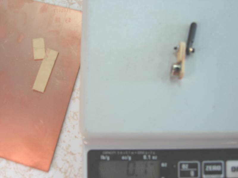

Throttle arm from a shaft collar some copper clad 'project board' Radio Shack, solder and CA. A Dubro 2-56 ball link was used. The carb return spring was too strong so I unhooked it from the throttle lever and let it unwind one turn, too loose (no tension), rotated the spring to let it anchor on another spot on carb body and trimmed it to clearance length.

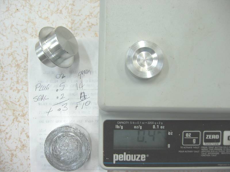

I would appreciate some input on making a plug for the rear case half to replace the seal when the crank gets cut off. I have the seal & bearings for reference. When making a plug seal of similar material, aluminum, should I make it the same diameter as the steel bearing? A plug with flat interior face seated against the clip decreases the case volume about 1.42cc or 5.6% of the engine displacement. From other threads I believe reducing the case volume is a benefit. Not sure just why; maybe someone can explain for us only semi mechanical hobbists.

Make the plug for a tight press fit, use Loctite and press it in....

Cut both ends off the return spring..It keeps the throttle plate centered in the bore at WOT...Without the spring pressure against the clip on the end of the throttle shaft the plate vibrates and wears out the plate and the carb bore, then it leaks enough to not shut off...
Could you give me a reference to say the diameter of the bearing. bigger, smaller, I can relate to a measurement. I do not know if you mean tight if I were tapping it in with a plastic mallet or so tight I should take it someplace with a small hydralic press and use like a socket to get it uniform pressure.
edit:
Probably would not need a sealer probably if it were a hydralic press tight diameter.

Tight for tapping in with a plastic mallet...Too tight will crack the casting...Plastic mallet tight with Loctite is good, the pressure in the case is only 5 or 6 lbs and not constant...

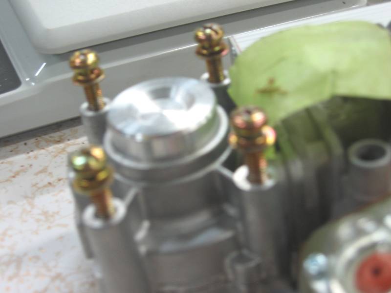

Third try and got a keeper! A little weight gain over the seal but maybe improved performance. Trimming the rear crank will give a nice weight reduction. Are plugs to replace seal available like from bearing shops?

Doesn't need to stick out past the case....

It is the same thickness as the seal, just sat it there for reference.
