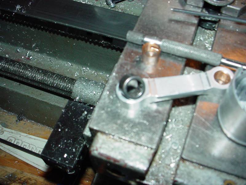

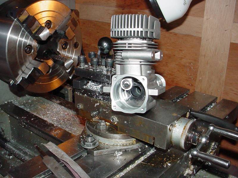

I have posted a few pics of the 90 and 2300 to show what is being done internaly

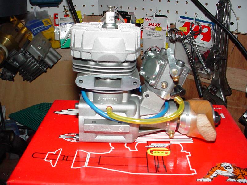

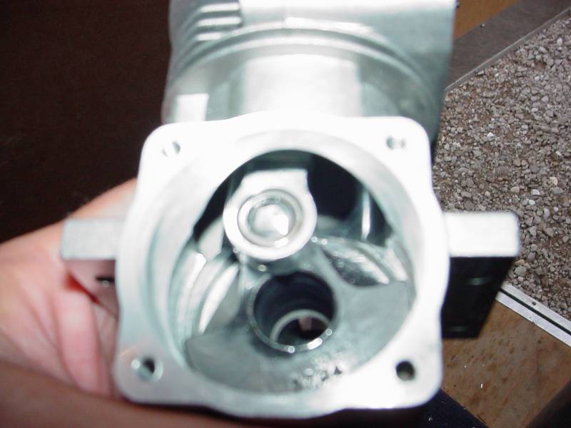

Old 04-08-2007 | 07:58 PM

here are some of the 2300 crank and rod bearing

Ken,
Are you converting both ends of the rod?
thanks, Will

I am modifying the small end and putting a needle bearing on the large end and machining the crank , it is not hard enough to carry the bearing

I put a needle bearing in the rod and make some oil holes and machine the crank pin and put in a hard ground one so the bearing will not eat up the crank and the piston gets some machining for the bearings to oil properly and there are other machining nessasary also . There are several hours of machine work going in to this engine so that the conversion will last a long time.

We had ST cranks check for Rockwell once. They were between 18 and 34 Rockwell, some even were different on both sides of the pin. Needle bearings need a MINIMUM Rockwell of 58. With out proper rework the crank pin will last about 2hr before it begins to spall.

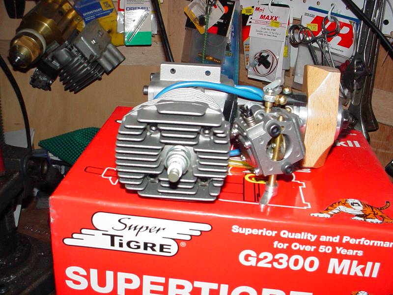

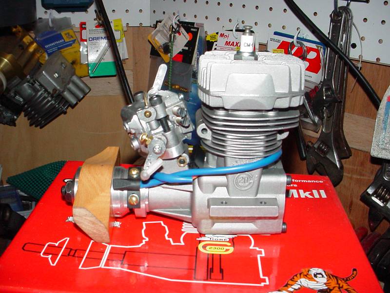

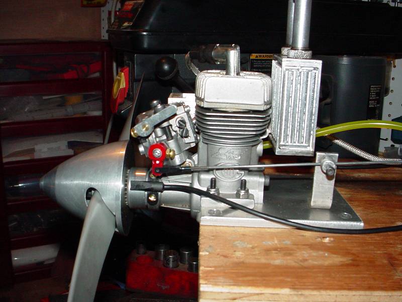

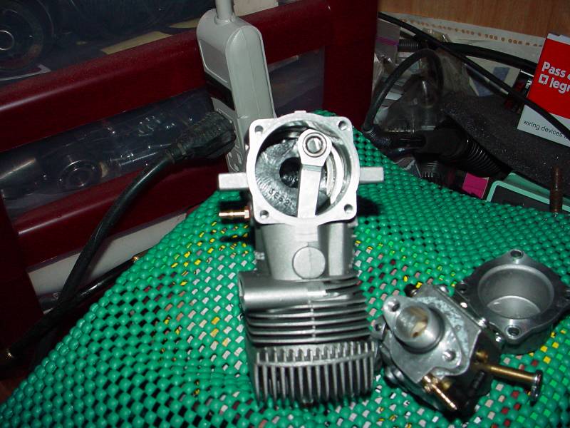

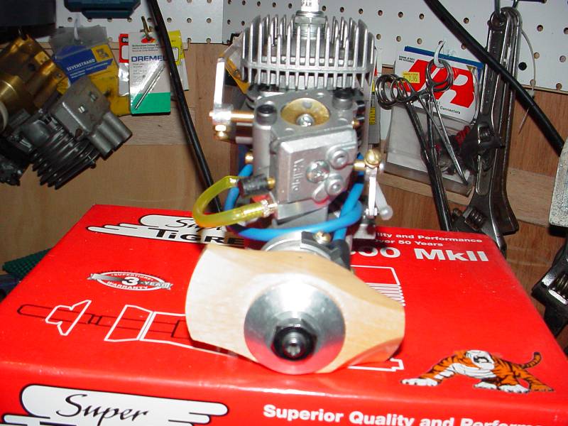

her are a couple finished one 90 and one 2300
I am working on 3 more each also

KenLambert: Nice looking gas conversion on that SuperTiger 2300. I bet it is smooth running. My guess it will be a popular engine in time. Best Regards Capt,n
