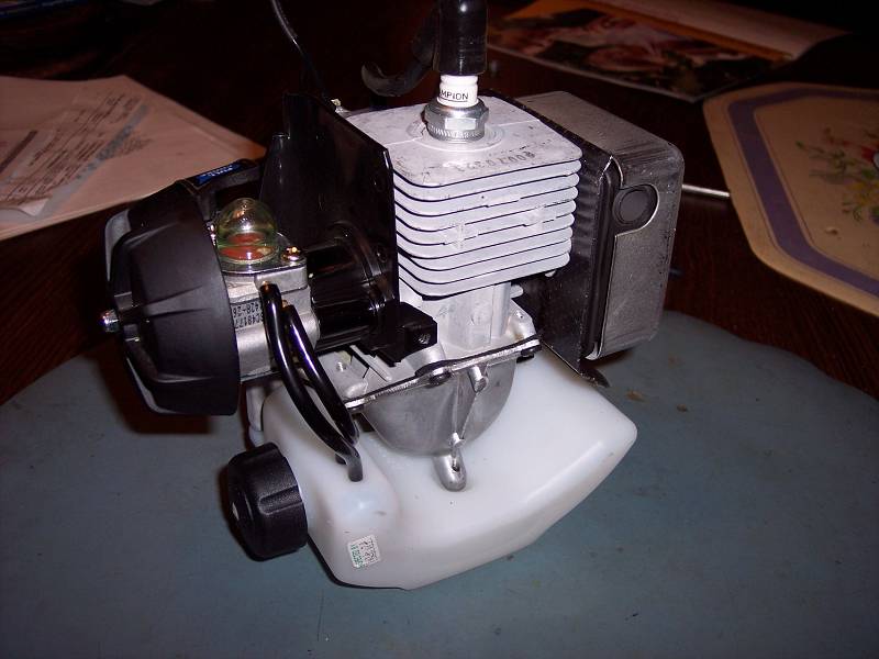

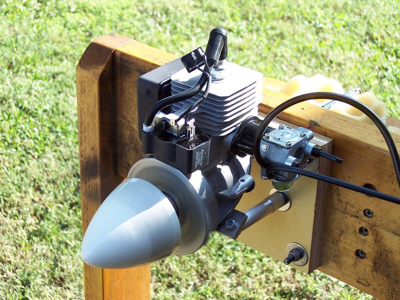

Here's Homelites new Chinese made motor. The adds say lighter and more power. It almost looks like Homelite told the designers to make sure it couldn't be used for R/C A little more trouble than most to make a mount for. One tank of gas through it in the weedeater, it seemed to have pretty good power, time to get to work. Oh, Home Depot has them for $67.

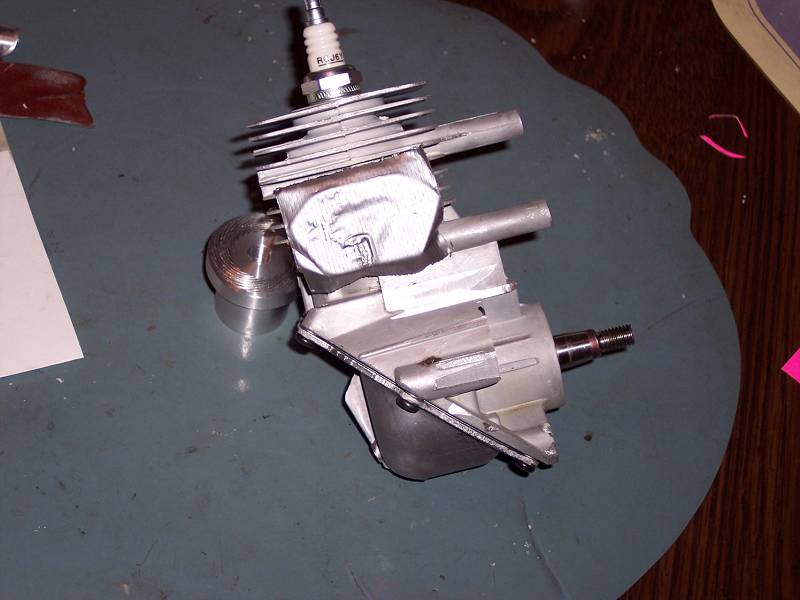

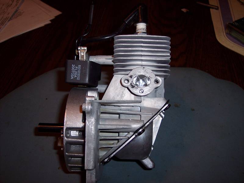

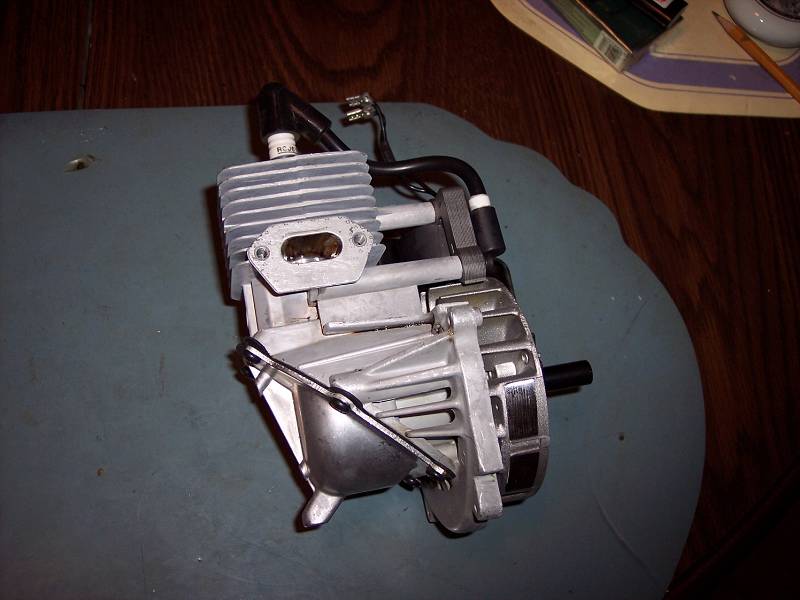

The cylinder and front half of the crankcase are one piece.

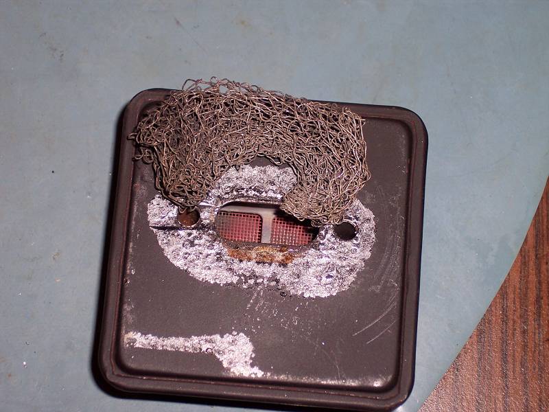

Old 10-07-2007 | 11:58 AM
Posts: 424
From: Naples, TX
Default RE: Homelite Mighty Lite 26

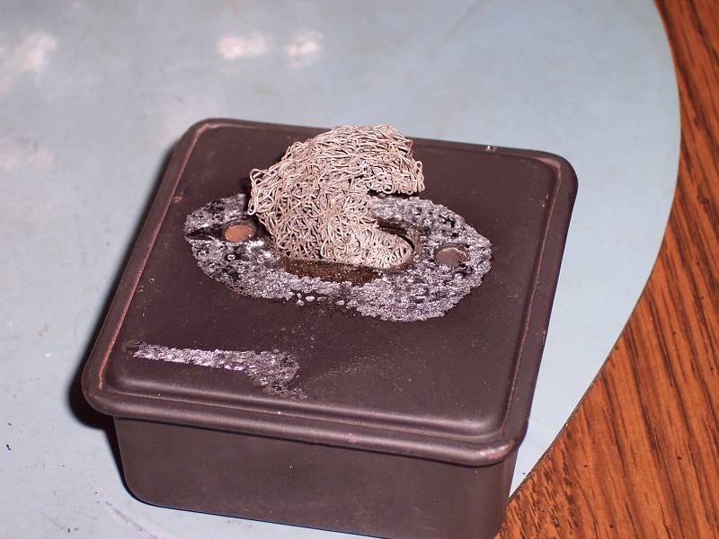

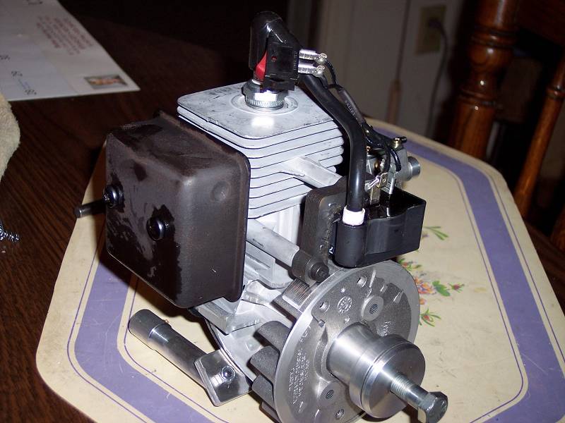

OK, clamp her in the milling machine and pull this heavy mesh looking stuff out of the muffler (don't know if it's some kind of catalytic converter or what, there is a separate spark arrestor)

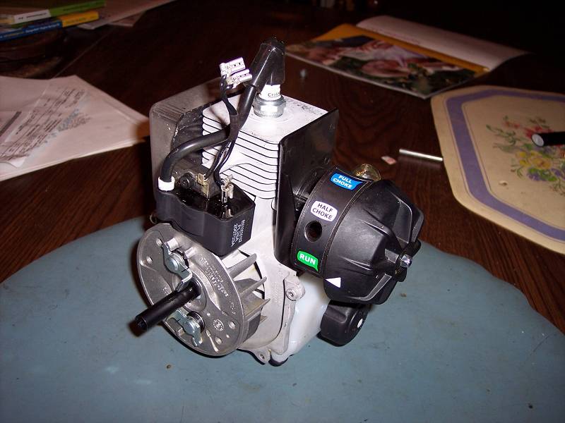

It started by hand easy enough, needles seem a little off though for this amount of load.

Old 10-07-2007 | 12:29 PM
Posts: 424
From: Naples, TX

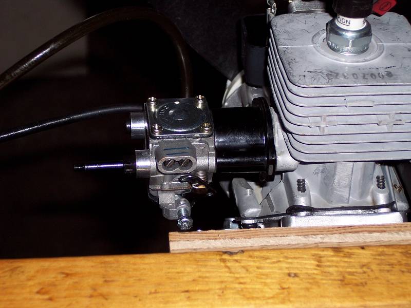

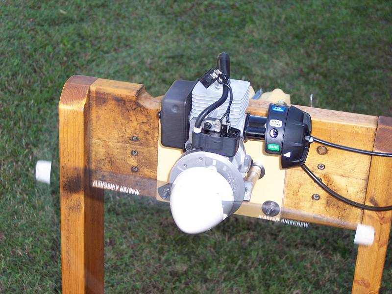

I flopped the carb 180* and slotted the needles this morning. Much better now with the needles properly set. 7190rpm on a MA 16x6, not earth shattering performance, but not too bad for a new engine with the stock carb and muffler.

Looks pretty good, what size carb did it come with ?
Old 10-08-2007 | 05:46 PM
Posts: 424
From: Naples, TX

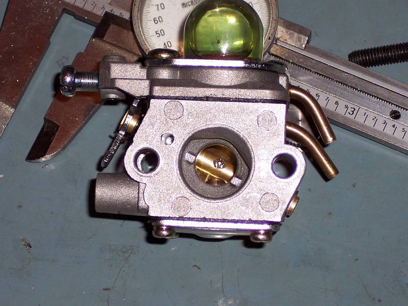

These Chinese carbs don't have the size cast into the venturi like the Walbros do. I just measured the bore the best I could with the carb still attached to the motor. .360 The carb may be a little small, but it is easy to adjust and seems to function very well. The motor runs cleanly throughout the rpm range.

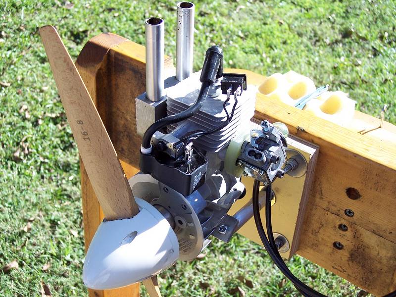

Right now, as pictured here, with the steel muffler and kill switch it weighs 3lb. 11 oz. I've still got some more work to do on it though. Going to make a G-10 carb rotator block, will either make or fit (if I can find something around here that fits) a lightweight aluminum muffler. If the weather is lousy this weekend I might even mill some grooves in the prop hub to lighten it a little. Got to give it a chance to run on equal terms with all the other weedies.

Now it's starting to come to life a little. 7440rpm this morning on a Bambula 16x8 this time with a B&B muffler still on the stock carb. Will have to try a 11mm Walbro next.

The 11mm Walbro got me up to 7530rpm on the same setup as above. Not that much difference. I've already gone back to the stock carb. The stock carb has a large venturi that narrows down to .360 (where the fuel jet is) and then opens back up to .490. Should work well enough for most people.
