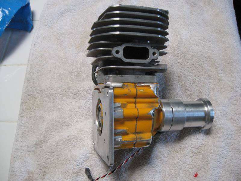

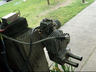

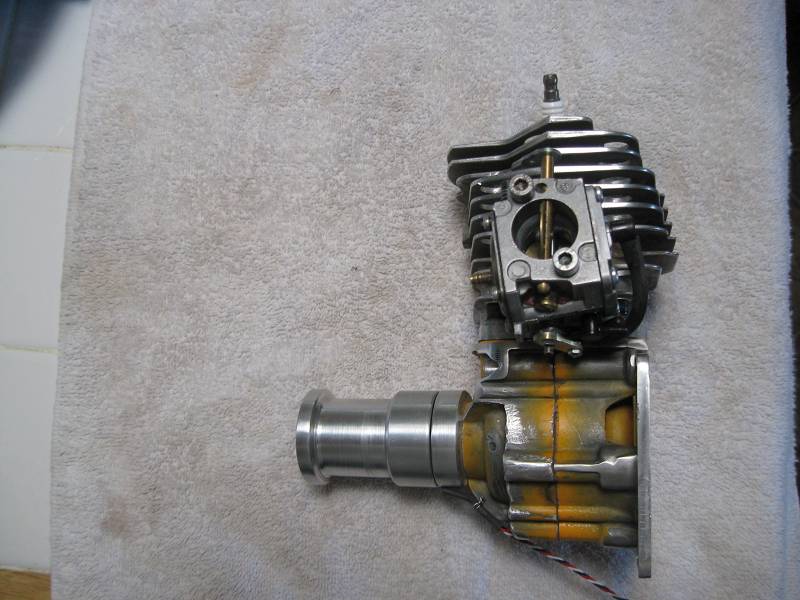

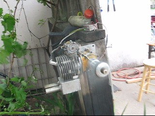

Well I got her running.
http://www.rcuvideos.com/item/BMV2KV388GZSF0NZ
I have 3 pints of fuel through her and it doesn't quite have the top rpm yet.
A little more fuel and I'm sure she will come around.
I'm running a 22x10w APC prop and it spools up real nice, just not quite the rpm I know it's capable of.
I made and designed the muffler. It has 2, 1/2 inch outlets and the Carb. seems to be louder than the muffler.
I'll give an update ASAP.
Did you notice the throttle linkage came off at the end of the video.
You should see how the fence wiggles and shakes with this engine on it.

I think 2 1/2" pipes are a bit small for a 70cc engine.

I would say so. I use two 1/2" outlet tubes on my 25cc engines, and larger for bigger engines. That is not enough outlet for an engine that size.
