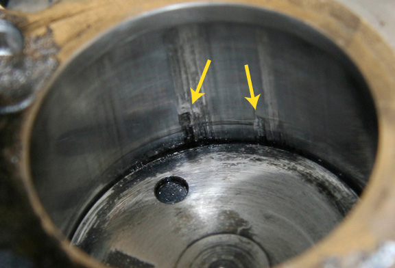

Here's a picture with the head removed. It looks like a couple of pieces of metal were shoved up from below. If they were above the piston rings, they would have gone up higher, I think. The gouges go all the way down to the bottom of the cylinder.
Tomorrow I'm going to take the back plate off again and look closer at the piston skirt and the bearings.

Check to see if the wrist pin locks are still in it.

Bet it's pieces of the ring. Gouges have that perfect square look.

ORIGINAL: Antique
That's sounds reasonable. I just have to figure out how to get the piston out to look.
Jim
