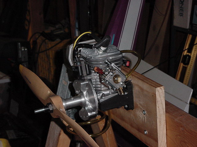

Here's a pic of my Poulan 46 conversion. I tried to test run it but it won't spark. It's on the stock magneto. Am I not turning it fast enough? I pulled the plug and spun it pretty quick but nothing. help?

What is the yellow wire on top
Milton

It's the kill switch, tried it open and closed.

The only other I can think of is the gap at the magneto.
I put a paper card to set the gap.
Milton

Could it ever be too close? Ran fine in the saw, I did drop it when removing it from the saw but, it landed on the spark plg and didn't even break that. Checked the coil with a meter and getting 30k ohms between the kill switch lead and ground and the same from center electrode and ground.

If you are using the same plug from when you dropped it, it might have a internal crack and shorting, try a new plug just use one from anything to check for spark or use a screwdriver in the boot and hold it close to the engine and see if you get a spark with out a plug but most times you dork a plug it will short internaly.

Thanks for the help, folks. I tunrned it over with my started and started to get some fire @ about 1000 rpm. No hand starts for this one! My starter turns it slower than my hand with the spark plug in, guess it is going to be electronic soon! Funny thing is, I'm spinning it as fast as a pull starter but still no spark.

Started it by putting a starter cup on my drill (after a couple hours work putting a spinner on). Has to turn over 1-2 seconds before she gets going. The stock muffler really holds this back! Only 5800 on a 20x8 MA wood. 6600 with no muffler. Just some tests, going to get an ignition for it soon.

I don't use these on my planes yet but I have repaired over 100 of them. I suggest you replace the plug and check the clearance on the mag to flywheel. Use a piece of cardstock Manilla folder to set the clearance. You should have spark with the plug removed and turning the shaft by hand. If the plug gap is .018. The spark should be blue not redish orange, I suspect you have a bad ignition coil. If there is not a good spark with the plug out it will be worse under compression. Good luck.

Das, Tks. The spark is orange at best and only when it's turning 1000+. With the plug out I can't get it to spark by hand, prob 5-600 rpm. Sounds like a bad coil.

Zagnut: I like your dual pickup idea for starting...might work for good idle also....if done right. H82crash: What is the fitting holding the prop on your engine? Looks like a Homelite part? Thanks, Captinjohn

It is a prop adaptor I made. I cut the head off an 8 x 1.00 bolt and set it in the adaptor with locktite. The nut is the stock Poulan nut from the flywheel, it is larger than other available nuts. I did it this way because the stud won't wear the threads in the aluminum and I won't have to be as carefull tighting the prop nut. Also way easier to mount a spinner adaptor.
