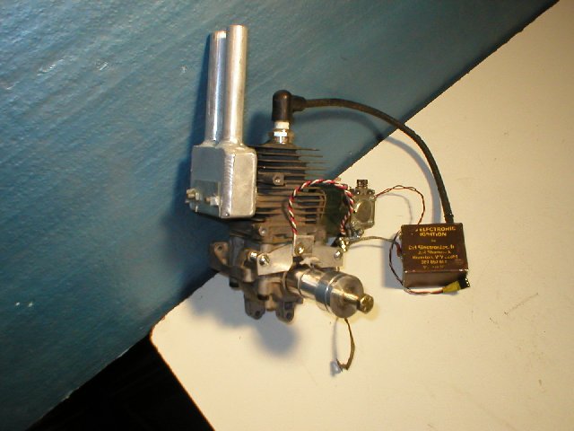

does it look like the one on the left.If so its a 25.9cc.I started this one but need new rings.The one on the right is the 28cc(27.2 actual).Thats a 17x8 prop on it.RTF it weighs 3-1/4lbs.I have a new tach but havent tested it with this engine yet.The 25.9 is suppose to be better and stronger because it comes from the pro-series as ive been told.I have prop hubs or can make you a special one if ya want on my lathe.Ive made a couple 6bolt.If ya have any questions PM me and ill help or just post it back here.Good luck but youll find out that one engine just isnt enough.

Go to chignitions and see what engines he has parts for.Also try wackerengines.jagengines,carrprecision.Also keep putting your engine in the search feature here on rcu.I do echos and stills basiclly.I have done homelites and ryobis but there not my favorite.

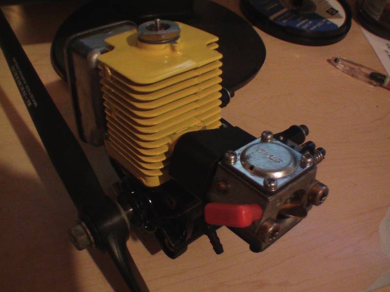

ok finally getting back to finish this project. it is a stihl 20cc \ 1.2 cu in. gonna run GloGas! i have a glow plug adapter now and have bought my ceramic engine paint and primer. all excess weight has been removed with grinder and dremmel. it is cleaned like a babys but after a diaper change. It is time to rock n roll...
2 issues.....
[sm=confused.gif]should i make prop hub out of the flywheel or find someone who can make one?
[sm=50_50.gif]the nut that holds on the flywheel to crankshaft is reverse threaded. will that cause a problem.
thanks for any input

2 issues.....
Just run the engine backwards with a pusher prop and the threads may not be a problem!!! Not sure on that. Capt,n

really... i was thinking blue threadlock.....???
Old 01-28-2009 | 10:02 PM
Posts: 12,957
From: Hesperia Michigan, MI
Default RE: Stihl - My First Conversion is to begin
If the threads are left hand....the prop may just come loose when engine fires!!! Be carefull. Capt,n [X(]

heres some pics.
[&:]thanks for the warning captJohn.
still need to turn my flywheel into a hub, then drill/tap end of crank for a stud for a prop nut. Do you guys think that would work??

what size prop to start with? it is a 20 cc wil run glow/gas

I would probably use a 14 x 8 to start....

Hey all
Got er done. had to find a left hand tap 8mm dia 125pitch.
now can use electric starter to get it tuned up!
will also have to re paint the yellow on the front because i didnt let the paint cure properly before i first ran it. its scuffed up from a chicken stix, fuel etc...
will post a final pic when done with that. now.. to find a bird to put it on, the hunt begins
robbinsp

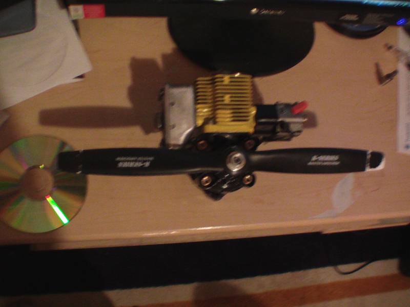

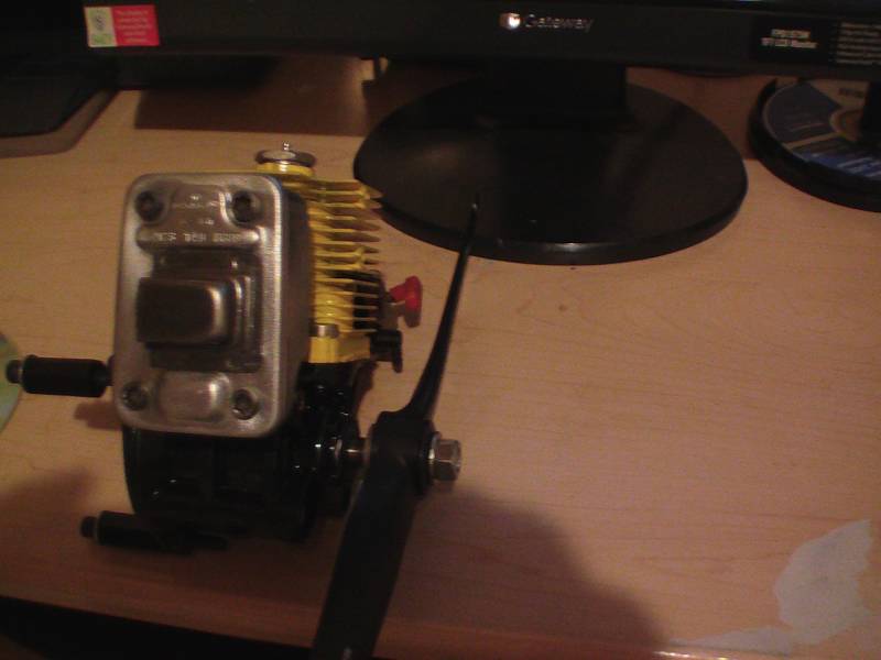

okay. heres the latest news from stihl airplane engine fanatic. sold the gas/glow at auction and was able to fund a cdi ignition unit. luckilly, i had another trimmer engine haqnging around. its off the same model weedeater. heres some pictures. what a fun project.
my next conversion will be a rear carb stihl 30cc! THANKS FOR ALL THE HELP.

uno mas!
