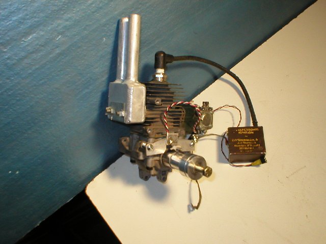

Heres a pic of one of my first rotator attemps(works).drilled a hole halfway through board then cross drilled so nipple would be out of evrythings way.Aluminum base plate is bolted to cylinder with counter sunk screws.Then carb bolts are run through carb and board and into the aluminum plate wich is threaded.heres a few names for the board:
Delrin
Acetal
epoxy board
phenolic resin
phenolic laminate
G10/FR4
Arboron
Micarta
Do a search and you should come up with a lot of Distributers.You can also use round stock,not just square stock.
