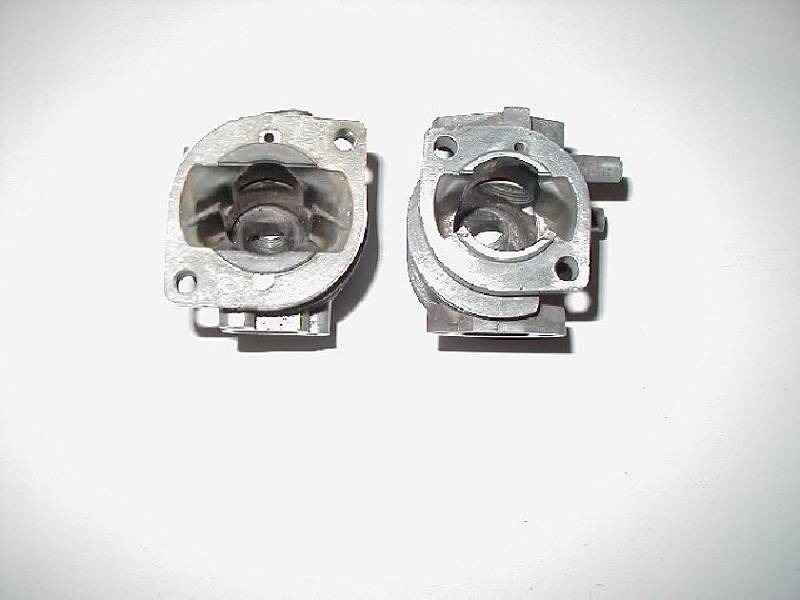

Just a quick question as to wich one of these cylinders would have more power and or better performance.There the same size,bore,stroke,ect...The only difference is that the base flange is a little bigger on the one.They are both off a 14cc echo.

Well Buck, my gut feeling is the one on the right. But then who knows, maybe those transfer port dividers point the flow more efficiently and make more power?? It also appears there is a difference in the exhaust ports, and that perhaps the one on the right has a slightly higher compression ratio. (Hard to tell in the pics....)
Unfortunately, you won't know until you do a back to back comparison. (times 2)
BTW, it's not too tough to change that engine over to a 21cc cylinder if I'm not mistaken...

I knew youd be the first to respond.I sent the other cyl"s(2) to frank for new rings since he didnt have the correct size so hes fitting the rings to my pistons and cylinders.I have 2 echo hedge trimmers with 21"s on them that run so i might pull one apart and see if the pistons will fit rod and cyl case..I bought 3 14cc from indiana but unfortunatly the base is smaller so the cyl bolts dont line up.So im trying my own twin.I tried to drill the crank like you guys did on your bme"s but i dont have a carbide bit or boring bar(my bar is HSS).
On another note,if im right.If the pin for the ring rides in the corner of a cylinder between the ports,ect,then the bridges arnt needed because the pin(ring end gap) is in constant contact with the cylinder wall.The piston on the right has no bridges where as the one (2) that came with my twin have a full bridge on exhaust and only have a half of one on intake.Well,ill see how it runs with franks upgrade.Who sells carbide bits for less?

It is tough to tell by the pictures... But the one on the left to me seems to have the smaller combustion chamber.
and the bigger ports.
I copyed them and made them full screen.
The smaller the combustion chamber the higher performance they ususlly are.

Thanks Ralph.Thats what i was thinking,when ya look at the base its bigger.Thats why the cylinder looks smaller.There both 14cc because the pistons from either engine fit the other.The one on the left also has the bridges in them.

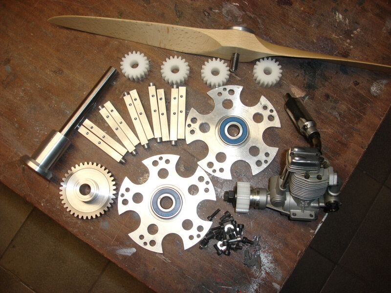

Well, here's one way to do it.
I can't think of any practical way to make a radial two stroke, unless you cheated like the pictures shown of a four stroke radial...

I love this engine. I wish it had audio to go with it.
I was actually thinking about a single crankcase set up like the BME twins we made.
How many degrees apart could those cylinders fire with out adversely affecting the second cylinder's performance?
This is a 5 cylinder engine made up of OS 70 engines.
And it turns a 22x10, same as my G-62.
I wonder how fast it turns it?
