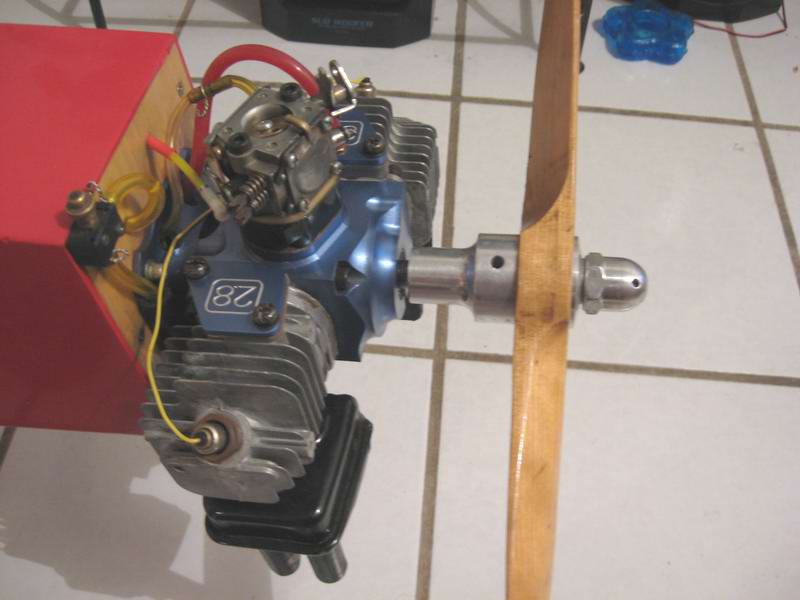

Well no, you wouldn't want the prop out at the end of a 3" plus extension! As I said, I cut my shaft off to a more normal length and rethreaded it, and used a reasonable length prop adapter. I think most prop adapters run more or less 2" in length, and that is enough to have extended out there without a third bearing supporting things.
Just because it was right handy here, I just now measured my 48cc twin that I made. It is exactly 2" from the crankcase, (which is very close to the front bearing face), to the prop mounting surface. My 30cc Homelite is in that bracket as well....
BTW, even the cantilevered crank engines like the Homelites have two bearings. They have a big one inside near the crank web, and a smaller one in the nose of the crankcase housing. Even the "smaller one" is a good size bearing...

48cc twin made from two 23.6cc Echo engines and a custom crankcase. No "vibration damper". Two inches from crankcase to prop mounting face. RPM's from 7000 to 8500 depending on prop. You can put a glass of beer on the fuselage at any rpm, and it hardly jiggles the surface of the beer!
Yeah I know, it's a twin and they usually have less vibration, but my Homelite singles also don't use flywheels and don't have any problems.
But hey, if it makes you feel better to run a magneto, go for it! It's all fun!

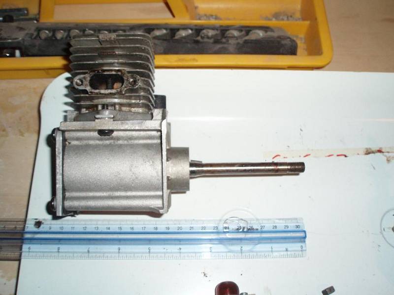

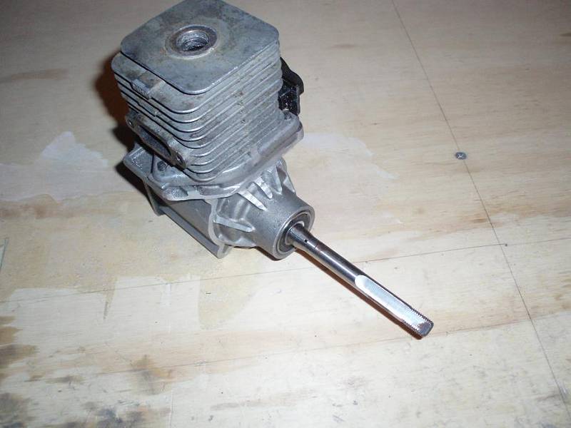

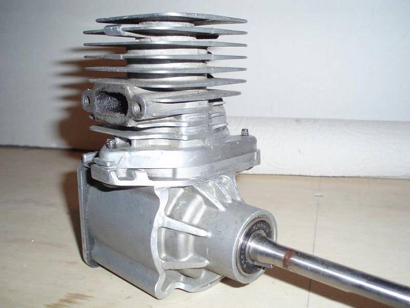

Well this is the Homelite so far. I haven't finished with the dremel yet as there is still more metal to come off! It's now down to 3lb with stock carb and exhaust. Still waiting for aluminium bar so that I can machine the propshaft and washer. I am going to order an aluminium exhaust to further decrease the weight.
Hey AV8TOR, see what I mean about the extra long shaft?!?!
First pic is just after I removed the blower and ignition mounting flange. The other three are as far as I have gotten to date.
Rich

Looking good. You've cut/dressed yours down more in front than most guys do. That's how I do mine.
That shaft is exactly how my 30cc was before I cut it down and rethreaded it.

GOOD! I was getting a tad wary abut how much metal I was cutting off but if you say they are still reliable thats good. I will be bench testing this engine thoroughly when I finish it. On that note have you seen any ultra cheap ARFs that are suitable for this engine and that fly well deadstick or with half the engine a mile away? I'm thinking that it might be a bit risky testing it in my P47.

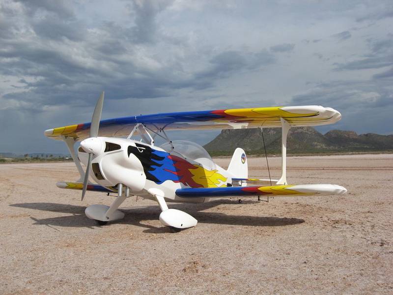

I'm telling you, you worry too much!! I put mine on a 1/4 scale Christen Eagle biplane without a second thought. Set up properly they are just as reliable as any 500 dollar engine you might buy.
But if you insist, try it out on a Giant Stik or something similar. I think the Goldberg "Wild Stik" is offered pretty cheap sometimes....
AV8TOR

Worry too much? Yeh! story of my life! That's why I have high blood pressure! lol! Without stress my life would be meaningless!
The same guy I bought the P47 from has a Giles G-202 67'' ARF for $79.99 so that's a possibility. I go past him on one of my routes so I don't have to pay shipping!
I like your Christen Eagle!

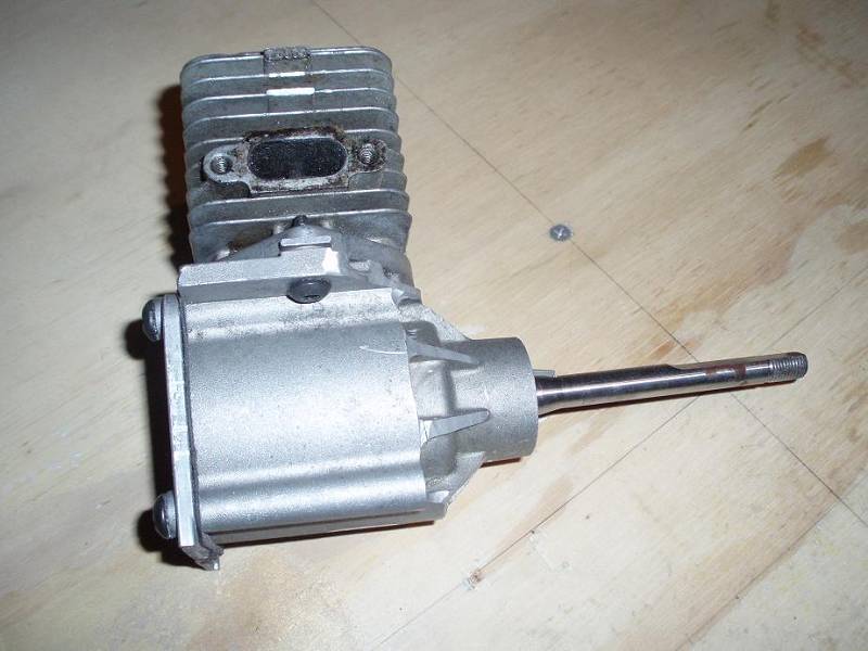

Ok here goes the next installment! Just finished in my workshop with the Dremel! Originaly the engine weighed in at 4lb 10oz as it left the blower. After much use of a hack saw and a dremel the weight is now down to 2lb 15oz with the stock steel propshaft, carb and exhaust! I probably could get it lighter by drilling through the fins and taking some metal away from the edges of the crankcase back plate but I think I will call it a day. I cut some of the front fins away below the manifold as these are in an area of high airflow and below the combustion line. The engine ran really cold when it was in the blower even though it was covered in grunge so I thought it would be ok if I lost a bit of metal from that area. Lets see. Next on the agenda is a light weight aluminium exhaust, new Walbro and to make the new propshaft. Pics below, starting to look more like a plane engine and less like an industrial unit!

Looks great. But now I have to tease you a bit...
A. It would weigh even less if you would cut that long shaft down to a reasonable length and re-thread it.
B. What happens if after all these weight saving endeavors, you end up having to add nose weight to your P-47?
Have fun!

P.S. Just noticed after a closer look at your pic that yours has the cast aluminum back plate. They also made those backplates in stamped steel and plastic, either of which is a bit lighter.
AV8TOR

Ha!
1- If I cut the crank it will be too light!
2- If it needs nose weight I'll just use a bigger prop nut!
The stamped steel is lighter?!?!? I've got one of those! :-) Shame it's on the back of my new 30cc! Hey just think if the 30cc is lighter to start with I wonder how light I'm going to get that one!
Rich

the steel is definitely the heaviest part of these things... you can hack at the aluminum all day and not make as much of a difference as cutting off an inch of that crankshaft...
