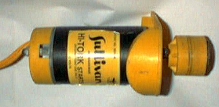

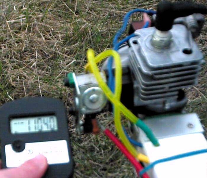

I ran my gas engine again today. The first time since rotating the carb 180°, mounting the engine to my fuselage, and installing the new Seeker II from Polk's Hobbies. Ground based range checks actually improved?!?!? Must be because I was at a different location.
I AM IMPRESSED!!
The RPM readings were better than I expected or even hoped for...
25 cc WeedEater® engine (Poulan),
Master Airscrew 15 X 8 prop (for break-in),
no muffler (not uncomfortably loud, but my muffler isn't done yet),
running slightly rich (4-stroking 80% of the time),
ESSO Synthetic oil mixed 40:1
RMP readings fluctuated at 9640 - 11040 !!!!!!
:boxing:
(Before anyone asks, yes, my tach is properly calibrated.)
With that kind of power, what prop do you recommend next?
P.S. More good news - my old starter (standard size sullivan) was able to start it repeatedly with ease.

Nice....
11K is pretty fast for a gasser...
Bump it up to a 16x8....
Look for 7-9K to be your best top rpm....whatever prop gets you in that range.
Are you using standard size PVC for your fuse? I'd Love to see pics on your mounting method.
Great work!
Keep us updated....
CrazyHerb
seriously, that sounds way too high for an engine that can you start with a standard starter. can you confirm the reading with another tach?
thats much more rpm than a g-23 with same prop so something must be wrong

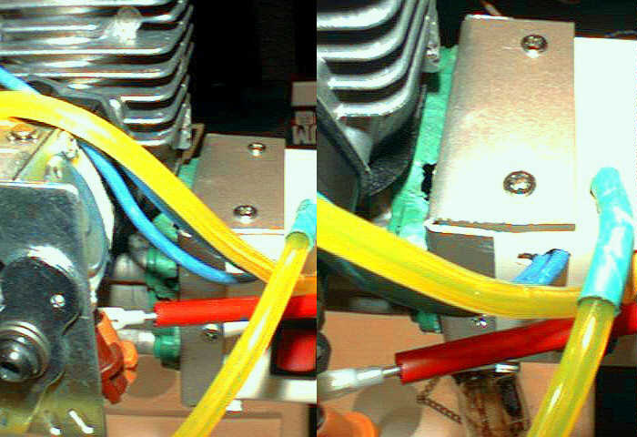

Zagnut - I was alone, hence the need for pictures to prove it. I have previously verified this tach is correct by comparing with another tach, and also by aiming it at a light bulb on 60Hz AC power, and get a reading of 3600 (60Hz X 60sec = 3600 "RPM").
CrazyHerb - Using 2" Canadian gutterpipe from Rona/Revy for the fuse. I bought an aluminum strike plate for where you push open a door and cut it into a square. Drilled the holes to match the crankcase of the Poulan and replaced the bolts with slightly longer ones to go through the plate and the plastic crankcase cover. This just barely fits inside the 2" gutterpipe. I then cut out the corners and wrapped the metal around the fuse. I placed plastic doubler inide the fuse al the way around the mount and then placed 6 screws through both. 2 on top, 2 on the bottom, and one each side.
Here's a close-up.
Here's a close-up.

strato911, sorry about the late reply. I kinda just forgot about about this thread. I was going to say that your 25cc Poulan should fly your "Blue Heron" just fine. With that much wing and at 10lbs, even a stiff piece of carbboard will lift off.
Not to doubt your RPM numbers, but that is one stout 25cc weedie conversion!!!! My twin-ring G-23 and single-ring 25.4cc Kioritz don't get anywhere near those numbers - and they are both "Pro-grade" weedies. If you can verify that the numbers are correct, I'm buying one tomorrow!! Try a 16x6 or 16x8 APC, and tach it in bright sunlight. I know my cheapo tach gets flaky when the sun starts to fade toward dusk. The fact that it fluctuates 1400rpm kinda makes me wonder.
Also, AFAIK spark ignition gasser 2-stroke engines do not "4stroke" anywhere near as much as glow engines do. That spark plug fires every up stroke regardless, so combustion happens pretty much every time. Now when the mixture is overly rich, it might "misfire" every so often, but I don't think it can "4-troke" 80% of the time. That would mean that the darn thing misfires 40% of the time.

Bap-bap-bap-bap-bap-brrrrruuuuummmmmmm-bap-bap-bap-bap-bap--brrruuuummmmmm
Almost like a Harley Davidson sound... I assume that was the reason for the fluctuating readings.The RPM's weren't changing wildly. For 20-35 seconds it would be 9600-9700 (sounding rich), then for 10-15 seconds it would be 10200-11000 (with a proper lean sound), then back to the rich sound.
The LHS is closed Mondays, so I can't get a new prop till Tuesday. I'll tach it again then, and hopefully I can get another person with a tach to confirm things.
If I knew I could consistantly convert these with those numbers, I would buy out the surplus center's stock and make my living doing conversions... This may just be beginner's luck, but I'm wearing an ear-to-ear grin.
