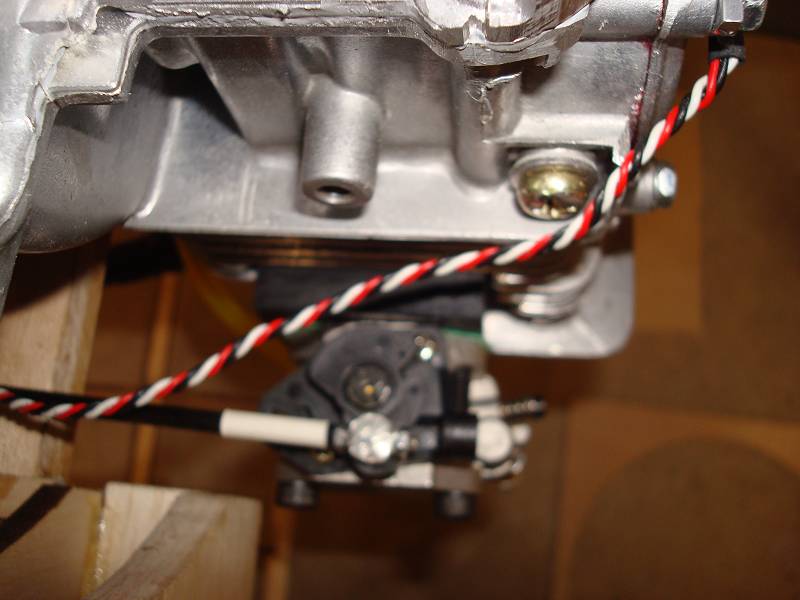

Looking for some ideas here. My GX31 worked very well on the stand. Although it was a little lean on the top end with the stock carb. However once I mounted it up on the plane and inverted it, the engine would quit when going past 3/4 throttle. So I got a WYK-16 from BCMA,,thought that would cure it but I have the same problem. Engine runs great up to about 3/4 then it falls flat on its face. I hung a WT 11mm carb on it and was able to twist the hi needle out about 1/2 a turn and bang ,,full power. But I figure I''ll loose the pump with that carb on this engine..Question is can the WYK-16 be richened up,,short of drilling the jet??? and what the heck does that black press down button do on the side of the carb??

Sounds like your needles need adjusting as the high seems too lean. I have used this carb in testing and have had no issues running upright or inverted. Mine is mounted inverted on the DVIII I am building. I also started with a WT carb with external pulse but the pulse line filled with oil and caused me issues. The high needle is to the right and just above the fuel inlet barb. The low is on top of the barrel and to the right of the swivel for the linkage. Look at my pictures to see what I mean. I used the stock swivel to attach my linkage to, worked well for me. I also made a manifold to rotate the carb for a straight shot linkage. So far so good. What I found when adjusting the low was to fatten it until I had a little black smoke then lean it down a bit. Tuned the high until it just stumbled at WOT then fattened it up a bit. Ran it many times in testing to fine tune and no issues to date. You will also know when it is rich on either end because you will smell like a bad running lawn mower in short order. These carbs and more important these engines tune a little different than the two strokes we use. What button are you speaking of?

Looks like something diffrent from the WYK-16 I have, Tim. Mine has no High speed needle,,Wish it did! I''d be set. The button I refered to is a start assist,,gives a shot of fuel,,kinda like a secondary primer after the primer bulb is used..

Post a picture of the carb if you can showing the top of the barrel where your throttle attaches to. I checked mine and it is a WYK-61. I may have said WYK-16 in another post so this will correct that. Are you sure there is no needle screw in the top of the barrel? Yours is a 10mm carb and mine is a 9mm. I have another one that is 10 or 10.5mm I intend on trying to see if I can squeeze a bit more power out of it. I do know guys have had issues with tuning with only one needle.

Tim,,I never have any luck posting pics here,,But I do have a needle in the carb barrel. Works great for the idle,,but my problem comes at the high end. Anyway since it worked OK on the stand I'm gonna have a real close look at the tank and lines first before I go looking to drill jets.

There should be another needle to the right of the fuel line barb. At least on the two I have there is.

I'm thinking your refering to the WYK-61,,,I have the 16,,No HS needle on those...Just the idle needle on the top of the barrel.

You are correct my bad. Either way I would try to locate a two needle carb. Better tuning capabilities.
