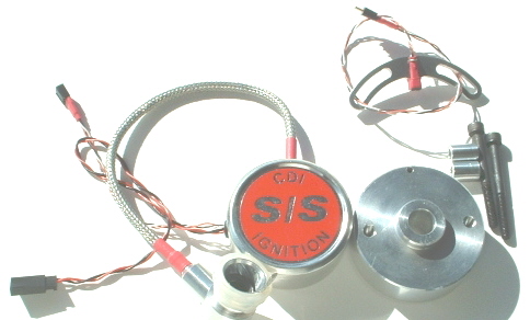

Iv decided to go with a S&S product.They look nice too.Don't ya think,,..

Have fun with the S/S unit. The comment trying to be made was that, from Marlowe for $70 you get a tested cdi board with a timing control built in NOT a complete ignition. To the $70 you have to add a coil, plug lead, plug cap, and a box. The savings if any is in your labor vs my labor, the parts are about the same.

I would have went with a Marlowe unit but,unfortunatly he is having supplier problems.As for the jerry howel kit.Iv heard that there is a strong strain on a battery with those units.Having any dwell over 35 degrees seems to not work so good.I decided to go with S&S because of talk at local hobby shop says that they are well built and obviously look nice too.
