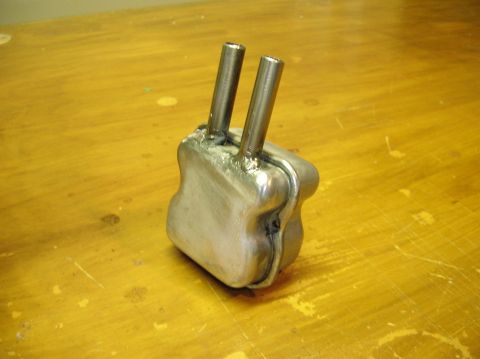

Now that I am finished with my 0% nitro glow fuel I was looking around for another project and came across this conversion forum. I have been reading here for a week or so and wouldn't you know it, my Dad's weed eater quit running and he went out and bought a new Stihl.
As fate would have it, I asked for the old one and he gave it to me.
I start tearing it apart and figured out it's a Poulan 25 cc. Four bolts in the back and springs holding the muffler on. The carb only has a low speed needle. The screen in the carb was plugged so I took it out and got it to run again.
I have another Waldbro carb coming with both high and low speed adjustment screws.
I have cut everything off that will not be needed. It will still have the coil and flywheel as this is going to be a low low budget build.
I couldn't get the muffler apart so I drilled out all the holes inside to 5/16" and also had room to drill a few extras. Drilled two holes in the top of the muffler, took the center pipe out of an old lamp I had , cut two pieces and welded them in. The welds are not the best looking....I only have a cheap wire feed welder, no mig, but it works ok for now
So far I have $9.00 in it (the cost of the carb and shipping).
Next on the agenda is a prop adaptor and maybe do something to get rid of the fins on the flywheel. I wish I had a lathe now[sm=72_72.gif]
I don't even have a plane for this engine but I couldn't resist the challenge of a conversion !!!! [sm=teeth_smile.gif]
Mark

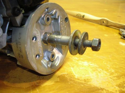

Thanks JG,
I used the shaft that was on the front of the engine for the prop adaptor.
The front half of the shaft was a square hole that the drive for the weed eater spool slipped into. I drilled that out and tapped it to 5/16 x 24.
I found an exhaust stud that was 5/16x24 on one end, smooth in the middle and 5/16x18 on the other. Screwed it into the shaft, found two thick washers and a nut.
Hopefully this will work.
Mark

Thats a good job youve done so far but i wouldnt bolt a prop on the front of that thin a shaft,sticking out that far.Are you planning on using the washer agaisnt the shaft and then the second washer against the prop?That is going to wobble and then fail in my opinion.You need to take off the square drive and then put a proper hub on.After you take the drive shaft off post here as to what threads they are and one of us or me can point you in the right direction for a proper hub.I even make my own and purchase somtimes also.I have some made up right now.Im not critisizing you at all,as i said your doing an excellent job, i just want to be sure you or someone standing around you doesnt get hurt.Ive posted a couple pics of how mine look so you can copy them.

Thank you for the reply Buck, opinions are always welcome. That's why I like these forums.
The thread on the shaft is 5/16 X 24
That is a nice hub in the pictures.
Also while I got you here LOL what is your motor mount made of and what is the thickness???
