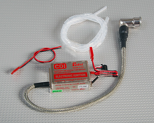

Does anybody know how good the XYZ engine replacement CDI units are that you can get from Hobbycity for $25 bucks are?
The Hall sensor is only $8 bucks.
That would make one cheap conversion ignition to help reduce weight on a stock weedwacker motor.
Wonder what kind of or where you could get a magnet to work with it to trip the hall sensor?
Thanks DC

The xyz is working well on mine. I have it on a homie 33 saw engine. I have not had one glitch or the batteries drain. If you run there haul you will have timing advance.

IF the magnet is stationary and the pickup is stationary, how can you have advance?
Does it do this inside the little black box?
ThanksDC

You can have advance 2 ways. The pick-up is on a movable holder that move as you open throttle...via linkage. The other way is auto advance built right in to CD unit. The 2nd is best...maybe. I think the RCexcell units have auto advanec built in. Capt,n

Hi all, I purchased one of those xyz ignitions. The thing had great spark. Tested it again after engine was installed and nothing. The ignition just sits there and has a load steady beeping sound. I did not use the hall sensor from XYZ do to the fact that it was for an RCS180 and hall sensor is in the rear back plat. Was wondering it anyone has had a similar problem. Also the ignition was out of Hong Kong don’t know if I will get another and risk my plane.
Duayne

Hello, I just purchased 3 of these. Only one seems to work when passing a magnet over the sensor. Will have to check the others a bit more.
Duayne, the hall sensor wiring polarity looks to be different from the standard Rcexl hall sensor with the positive and negative swapped around.
The early (V1?) Rcexl ignitions were like this also. This maybe your problem?

Tride everything. It was working, then nothing. It just sits there and hums. No spark. I think I should of just get a CH ignition. I tried it with my two other C&h ignitions and it worked great. If anyone needs the wire code for a RCS 180 just let me know. Maybe you can have more luck with it then I did. $33 down the drain. live and learn.
Duayne
