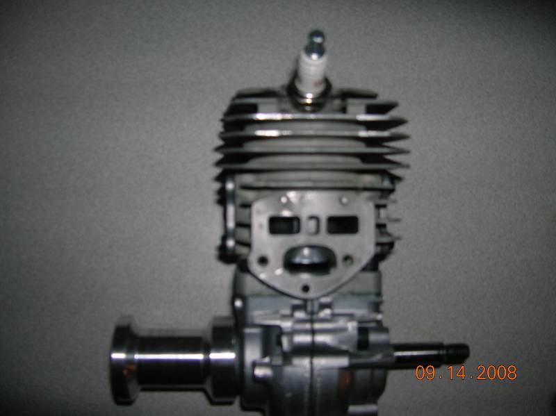

Old 09-14-2008 | 08:06 PM
  #44
My Feedback: (29)
Posts: 192
From: algonquin, IL
Default RE: Lets do a 40cc ryobi conversion!
captain, heres some pics for ya....one of the engine and one of the intake.

oh, also the carb is a zama c-10....maybe Ill get a walbro 264 or something..
I wonder if the 2 upper ports connect to through a channel to the 2 side covers with 3 screws? I am going to search thr Ryobi web-site for any expalnation how this all works! Capt,n[:-]
Old 09-14-2008 | 10:09 PM
  #47
My Feedback: (29)
Posts: 192
From: algonquin, IL
captin,
yes they do.....in fact,the piston has a "channel" cut into each side of it. I dont know weather to classify this engine as a "piston port engine " or what.[sm=72_72.gif]

Just cut a new intake gasket with out the extra holes, just for testing. Easier than tring to get thumbs there and start the engine.
