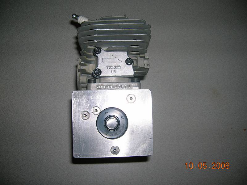

Ok...I got the motor mout done ( I still need to drrill the holes for the firewall or stand offs) This engine is ez to make a mount for, just use a flat peice of aluminum.Also the prop hub is now complete with stud and washer.Next I am making the new intake. It is actually is looking like an airplane engine

billzair, We are on a trip to visit my Grandson who works at MSU in Marquette Mich right on Lake Superior! It is cold here, but the fall colors are GREAT! Sure is good to see your engine photos. I hope it runs as good as it looks. Best regards, Capt,n
