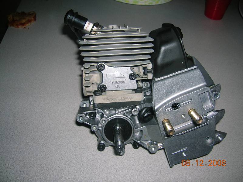

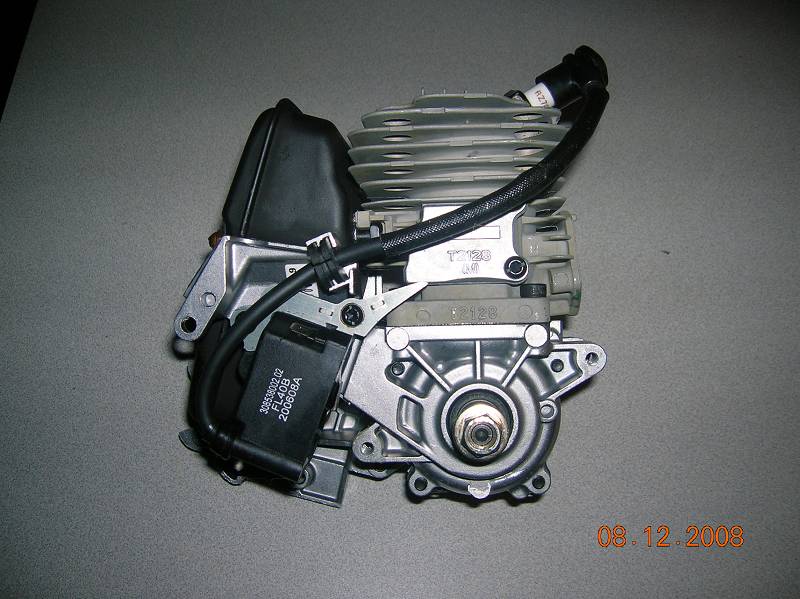

Alright, since I havent seen any one do one yet, and their on sale......Im gonna convert the ryobi 40cc saw and use electronic ignition.
I was trying to decide between a poulan 42 and this one.After pulling them both over, I chose the ryobi because the compression was MUCH stronger! I will post as much as I can and after Im done I will give total weight, prop rpm etc....hopefully well have a lightweight powerfull engine.Lets get started.......
Here are the first engine pics............suprise, suprise.....the cylinder says ZENOAH.
theres some cutting to be done and you could do it with a "hack saw" but Im puttin this in the mill at work .
Also,the carb manifold has those "secondary" intake ports for emission purposes...[:@] but maybe we can block those ports with a new
intake?well tackle that when it comes.You could use the stock coil and magneto if you wanted but its side mounted and its ugly..LOL

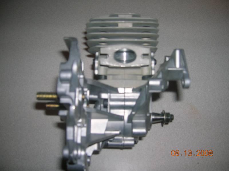

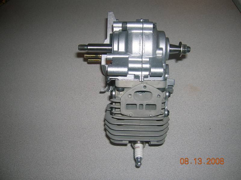

Old 08-13-2008 | 08:53 PM
My Feedback: (29)
Posts: 192
From: algonquin, IL
Default RE: Lets do a 40cc ryobi conversion!
ok...today I removed the coil and the muffler. The block is now ready for some milling! I cant believe how light the coil and flywheel are.The flywheel is also pretty thin too.Its a bummer there mounted on the side like that. The crankcase is small, as you can see. That should make the engine really want to draw fuel/air.
After the milling is done Ill start the prop hub.Im thinking about a 18-6 for a starter prop...hows that sound?

Old 08-15-2008 | 09:01 PM
My Feedback: (29)
Posts: 192
From: algonquin, IL
Alright lets see if I can awnser some of these questions...
The threads on the crank are 8mm x 1.00
The plates on the front and back have ports under them that are directly tied into the portion of the intake manafold that lets air in at higher rmps. This seems to me to be epa related, because the ports under those plates will not be transfering fuel/ air mix.....just air making it run "cleaner" Im not sure how they do this without making the engine run to lean ??

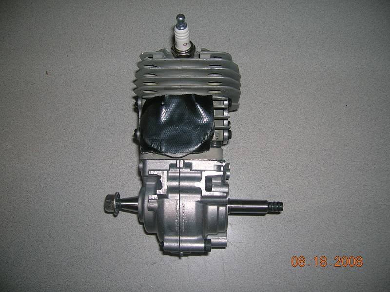

Old 08-18-2008 | 09:55 PM
My Feedback: (29)
Posts: 192
From: algonquin, IL
Well, milling is almost done...just have to finish up the "detail" work then Ill start the prop hub. As it sits now it weighes in at 2lbs 7 oz.
Im sure I can get it down to 2lbs when i trim the rear shaft off and finish the milling. I think(dont hold me to this) I can have her ready to fly weighing...3.8 lbs
Do you guys think that a respectable weight for a 40cc gasser?
