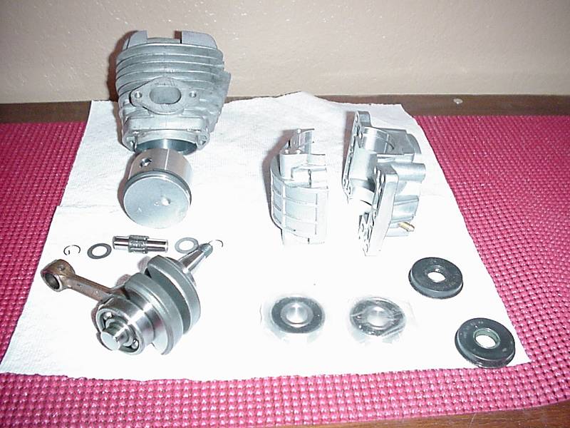

Echo -45cc-out of blower.Little bit harder to convert as it has a straight shaft and not tapered.But really no big deal.I have a hub started.Ill post a couple pics tommorow when i have daylight.Besides,i cant find my poulan 42,i know its somewhere.I also have a 45ccecho.
