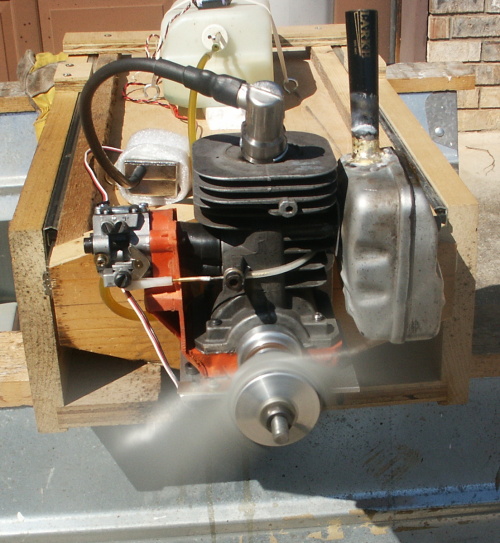

combatpilot said: I would really like to see how you measure static thrust. I am thinking maybee fabbing a test stand for this
My stand is nothing more than a drawer with heavy duty slides. The drawer pulls on a digital "fish scale" that I got at Wall Mart. It was only 20 some bucks if I remember correctly. The scale goes up to 50 lbs and appears to be pretty accurate based on some dead weight measurements. I screw the platform down to some saw horses.
Here's a 25cc Husqvarna brush saw conversion I just finished running on the stand.

DRAWER SLIDES? damn could it be that easy. Ya i tend to overcomplicate things. I was imagining a linear bearings and roller bearings lol.
I knew I shouldnt have scrapped out that filing cabnet last week. It had some real nice heavy ones. darn it guess im gona have to do some scrounging lol. I need to make a new test stand anyhow as mine has suffered from vibration damage.

i am hoping that for safety's sake there is a stop/limiter of some sort (other than fish scale) I have heard of people using an old skateboard with a track make with 1x1 boards. but the drawer idea applies to the KISS rule.

That's a great idea, and I love the megaphone exhaust stinger!

A cable would make a simple saftey stop. Its darn cold here today to and I really dont feel like going to the shop when its this darn cold. It sounds like a good day to go scrounge a drawer. I cant wait to get the parts from ajonr. I know im gona spend hours staring at them in comparison lol.

Yeah, there's a stop on the slide. In addition I have a wire link made from coat hanger that restrains the "drawer" when I'm just running the motor up for tuning etc. and I replace that wire with the fish scale when I want to take thrust data.
That exhaust stinger is an old "Clark" Irish tin whistle. It already had the holes in it so I just cut a hole in the stock muffler and stuffed the end of the whistle in and brazed it up. It works great and it's pretty quiet.

Default RE: another darn ryobi post (ryobi performance modification, analysis and comparison)
I got to run my engine again today. Unfortunately there is no video cause my camera died on me. I got the mixture set pretty close, but the high end should probably be just a touch leaner (again thats where a tach would be nice). Idle and transition are really good. I still get a bit of a hesitation when i snap the throttle shut (probably faster than the servo can move) but other than that, it runs great. Ive got a good start sequence down, and it usually starts after a few flips, and occasionally on the first flip. I have about 1 1/2 liters through this engine, and a total time of about 1.5 hours. I like to keep a log of the time on the engine, but it was hard to do that when i was setting the mixture, cause it did die on me a few times. The ring seems to be good, and compression is starting to come back. I really wish i could get an rpm reading. I think right now im on the high side of the limit with the 18-6, and i would like to get a 18-8 to be safe. I kinda want to tear down the engine and inspect, but its running good right now, and i would hate to jinx it.
