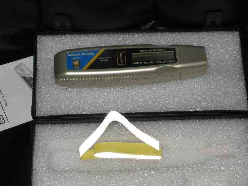

i just bought a tach from princess auto today. they had one on sale for $20, so i couldnt pass it up. i think that this type will be more accurate, cause i need to attach reflective tape to the prop. It says that the readings are +- 1 rpm and the max range is 8 meters. I wont have time to run the engine again til tomorrow, or monday. I will have a helper with me, so i hope to get a good video for you guys. I contacted frank about a ring (single ring piston) so i will probably be getting it in the mail in a couple weeks or so.

andrew66 said: i just bought a tach from princess auto today. they had one on sale for $20, so i couldnt pass it up. i think that this type will be more accurate, cause i need to attach reflective tape to the prop. It says that the readings are +- 1 rpm and the max range is 8 meters.
Wow.... +-1rpm! I never see a digit in the "ones" column on my tach. How is this tach different from the ones we buy from the hobby store that would make it more accurate?
Pic Pic I want pics lol
From what i understand this type sends out its own light source much like the light signal in your tv remote. it is then reflected back off of the reflective tape and with this light source it is less likely to be affected by other light sources. The regulat hobby one uses ambient light and this is why it just wont work in a room that has floresent lights.

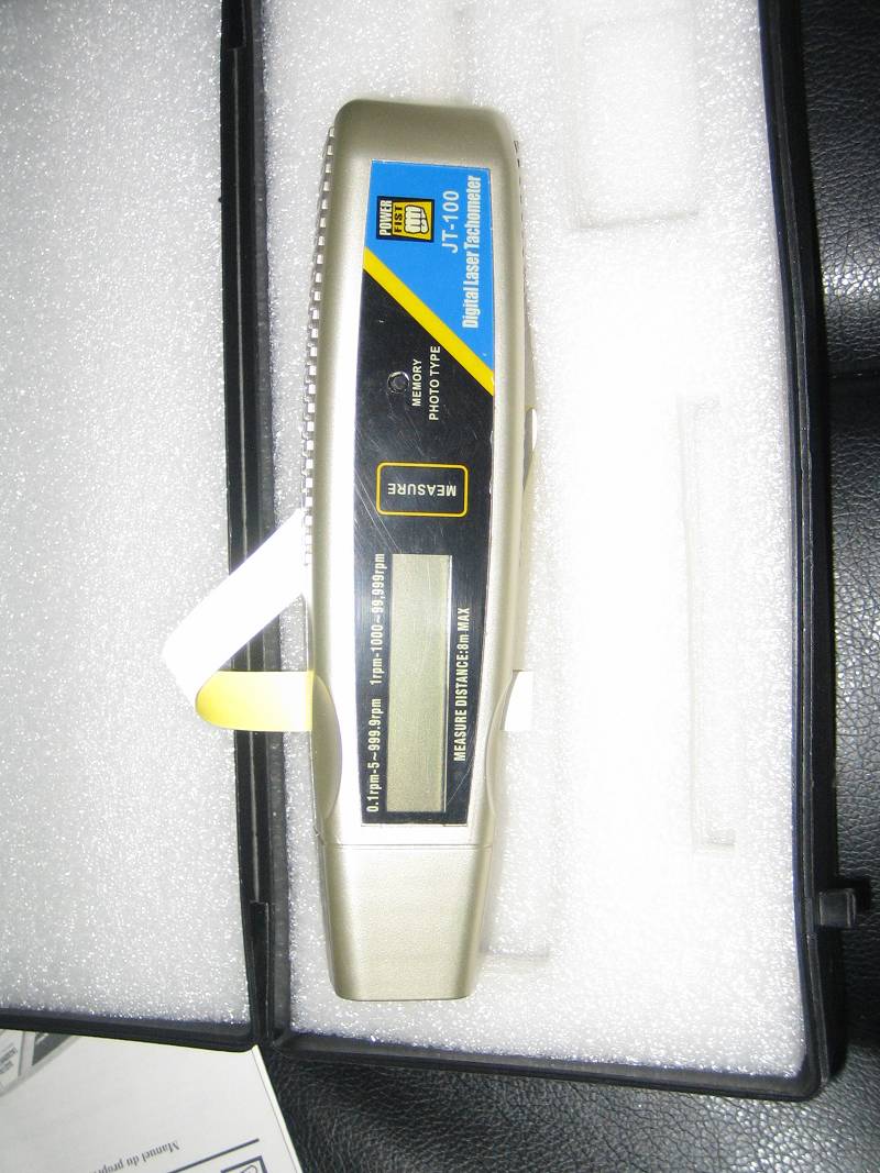

i will get pics of the tach later tonight. I think it is more accurate b/c it has a laser that hits the reflector tape (sticks to the prop) and it measures the rpm from that. It says it has 5 digit read out. This tach is normally around $60.00, thats why i didnt hesitate to buy it. lol

i got a pic of my tach. The brand is power fist. Just for the hell of it, i put a reflector on my fan in the house to test, and it works beautifully. It wont pick up a reading unless the laser beam hits the reflector. And it reads down to 1 digit.
here are the pics

Man that was good deal for 20 bucks. did they by chance have another lol?
