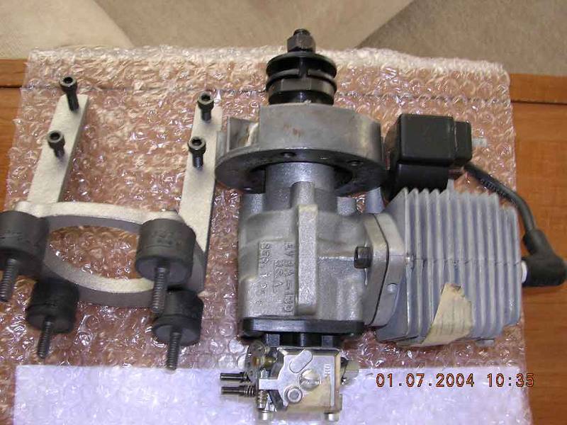

Swap meet/Ebay time.
Evra 190 was sold by Hobby Lobby for a few years. Its a Ryobi 31 with mounting rails cast in to the crankcase.
Old 02-17-2009 | 02:16 PM
Joined: Dec 2002
Posts: 234
From: Chiburbia, IL
Default RE: another darn ryobi post (ryobi performance modification, analysis and comparison)
ORIGINAL: tkg

Test # 10 Best of 1-9 and and try to reduce crank case volume. Record RPM
Test # 11 Best of 1-10 and use electronic ignition. Record RPM
If have money and time I may try to make the y manifold
