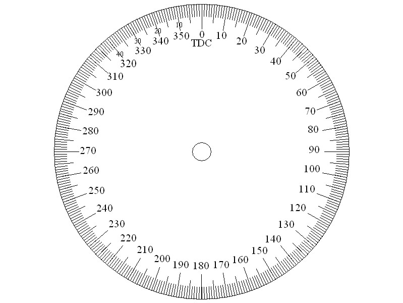

I fooled around on my CAD program tonight and made a full circle degree wheel of about the right size for our little engines. The automotive ones available are a bit too big. I hope it uploads in full scale. It's 6 inches in diameter. Let me know if it bombs.
diceco
To get it to print full size:
click link for full size below thumbnail in post. It will open in a new tab in the browser
save image
print image directly from file folder where you saved it.
That worked for me anyway.

for the timing wheel that i made, i just did a google image search. It took a few mins, but i found a suitable one kinda like yours. I just printed it off and used spray adhesive to glue it to an old beer box.

I think your gona want something more rigid for your degree wheel. I used 1/4" plywood. I think 6 inches is about right. That gives good resolution and allows you to mount your needle off of the ignition coil boss
