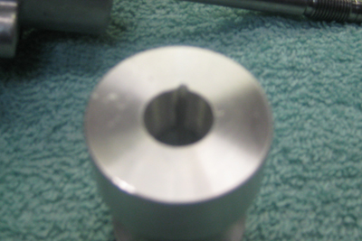

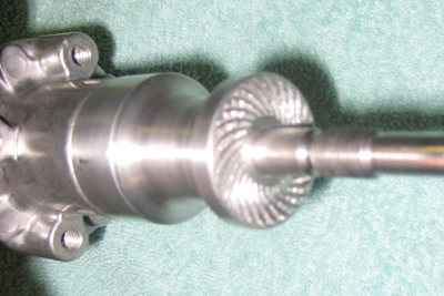

Here is my take on the prop hub issue. All I need now is the Hobbyking CDI unit w/hall pickup and a magnet.
#41
Looks great. Did you make it from scratch, or use the old "cut the center out of the flywheel" trick? Can't tell for sure from the pics what I'm looking at. Also, what carb is that with the nice looking finned cover?

I machined everything from scratch. I was going to use the flywheel cut-out method, but I think this setup looks way better than anything I could cut off my flywheel. Besides, I didn't have the right dia. pilot to use with the holesaw.
