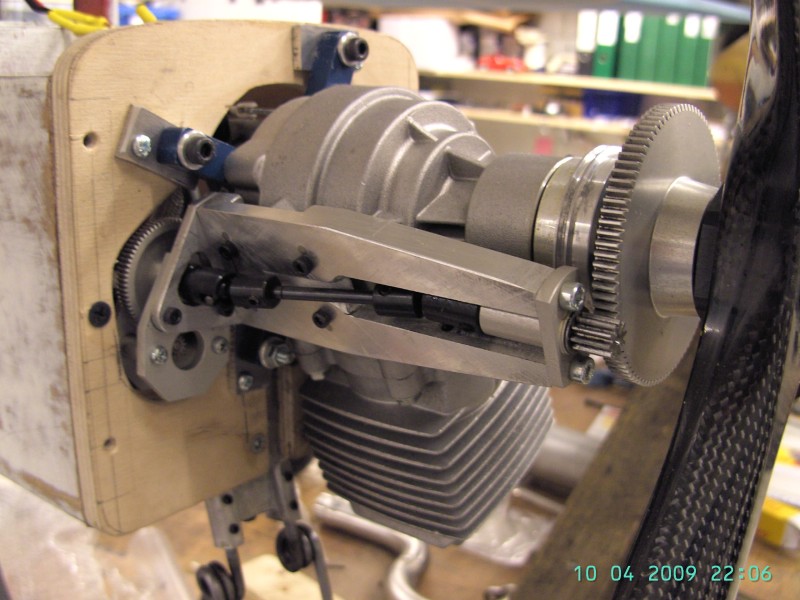

Hey kids, want some real stuff to play with? What about this on board starter, uses a speed 600 motor, and responds to the touch of a button on your transmitter.

That's a neat looking set-up, what does it use for a battery, and wat is the total weight, appx. I meant to say a McCollough Chain saw engine. Most ot them have a shaft on either end, and most Homelites do as well. Flathead
Old 04-10-2009 | 04:43 PM
Posts: 6,571
Received 5 Likes on 5 Posts
From: Arcen, , NETHERLANDS
Default RE: Gas engine starter
weight is about one lbs, including the 3S lipo.
Adapting the system to the rear cone of course needs some machining skills, but IMHO can be done very well.

Pe, how do those u-joints hold up. I like that setup. Has anybody done a bendix setup to the starter ring?

The U-joints are onder no kind of real load at such small angles, so they hold very well. Would do even better with a dry moly alloy lube, or just some graphite dust rub.
Please disregard the electric's guy's comment. The Lord surely forgives him, because he knows not what he just said.[]

Really nice setup, pe reivers! [&:] It's the first hybrid plane I see (kind of a flying Pryus)!
