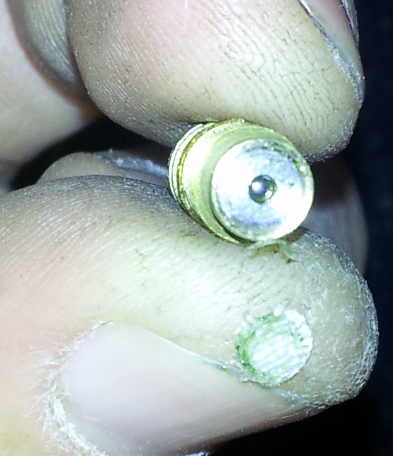

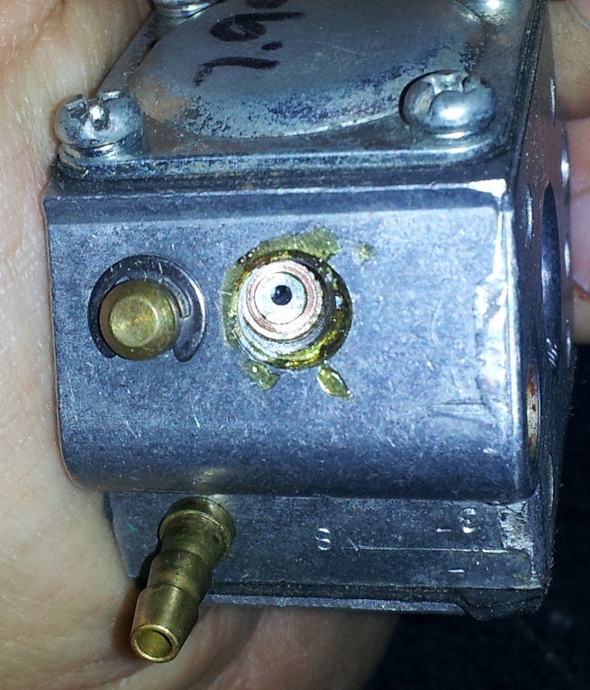

My Feedback: (11)
Hi Rick,
Here are some close up pictures of WT-37-1 that I think is absolete and hard to come by.
The governor is good but not for us we want to go hi RPM's not to throttle back.
The stuff I made is real hard to see in one of the pictures ...is on my tumb were the governor can be seen.
You screw it out, make a small round piece or you can solder shut the hole the is on the side of the governer
in the grove . But then will be hard to revert back later.
As far as intake...I do not know if you refere to mine or not but mine is simple. Instead of going outside and have a tube and more work....
I just went inside.
And here is a list... PDF of all carbs that MYWIFE !!! Camelia put together for me. All barrel carbs and butterfly WYK and WT from the smallest to 12.2mm venturi.
Where you see no price...is no longer available. On WT series all carbs that have ACC Pump if say no does not have it but my worth to try. On WYK series are all carbs that have both needle LO/HI. So she did this in 2 days. over 1000 carbs that she went trough.
Thank You
Adrian

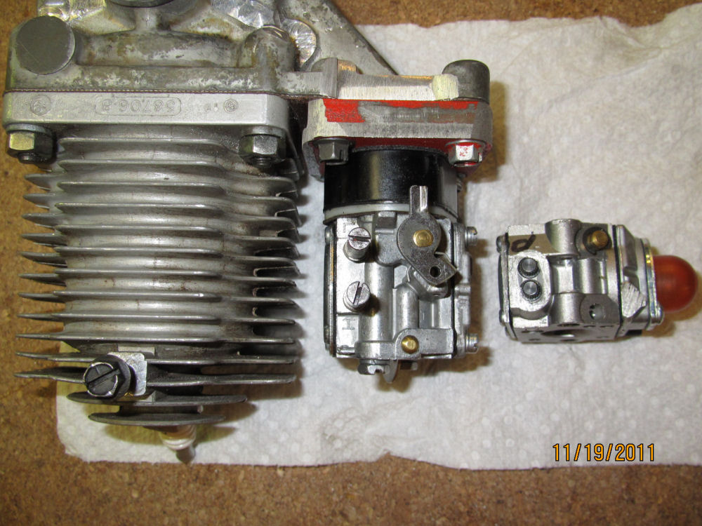

Here's a teaser. Anyone ever seen a giant "walbro-like" carb such as that shown in this picture, next to the mystery engine, which is my current conversion project.

Nice detective work. It is a Tillotson HS-179B. I don't have any specs on the carb, but I do have a rebuild kit for it. Tillotson was a Borg Warner company back then. The engine is a Homelite 54.2cc, quit a monster. The book says it also was fitted with an "equivalent" Walbro SDC62. That has a WHOPPING 14.25mm venturi.
