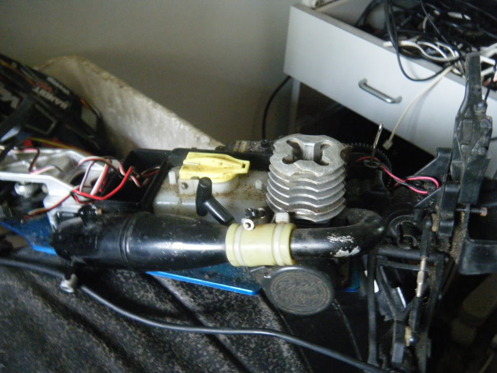

you read it right im going to convert an os .18 to steam.
i know it wont be usable for anything, much than a working
model but i have a couple of these lying around and saw
a weed eater on the net converted to steam.
anyway i need someone who knows anything about the timing
of this motor and what i might need to block off to get it going.
it should work, i have released the crankcase pressure and am
working on a flywheel.
if anyone has any knowledge of steam or has done something similar
i would like to hear from you. i had the parts sitting here and am fascinated
with having a motor run on steam. maybe im a nutter? lol.
comments welcomed.
cheers.
motors origin-
motor stripped with proposed flywheel-

Oh dear!
Low rpm small displacement engines on steam never quite made it beyond the showbench. For simplicity, you could use the CO2 engine principle with a piston operated steam admittance valve. There would be uniflow, and least pre-condensation/after-evaporation problems. Apart from that, it would only require a new head and plumbing, with open crankcase and occasional drop of oil to the rod/shaft.

Ya a half of a turn. Pe is on the right track, check out the operation of the small CO2 motors
ORIGINAL: Ralphbf
It can't be that hard. ..... If you put compressed air in the glow plug hole it will spin.

ok i have found myself that i dont need to block anything.
yes it only spins half a turn. but with a flywheel, and no crankcase
pressure it will return to the top if the air/steam injection is timed.
i have fitted the flywheel and made a timed valve that will get air
or steam in just after TDC. one quick punch of gas. i have also drilled
out a glow plug and just need to work out the plumbing.
after sitting down with this little motor and blowing through a fuel line
into the spark hole ( compressor isnt with me) i reckon it should work.
i appreciate the comments
i will try to search what i can, more info would be great.
cheers again.

cool link. that, as far as i know is the bash valve idea. not bad
if you wanna go screwing with the piston. i just drilled and screwed
a dome head screw into the flywheel, and made an arm to hit it from
an old servo horn, works like a charm.
just thinking about the plumbing and getting my compressor back.
heres a little video showing the valve i made moving, before i soldered
on the connections. the quality is poor but if you look closely you can see
the valve moving up an down in that little hole.
http://www.youtube.com/watch?v=uFDjBQ7OkI8
im thinking of drilling out the head and re tapping it for something bigger
were the plug went, but am unsure. some stuff to think about.
cheers.
monster.
