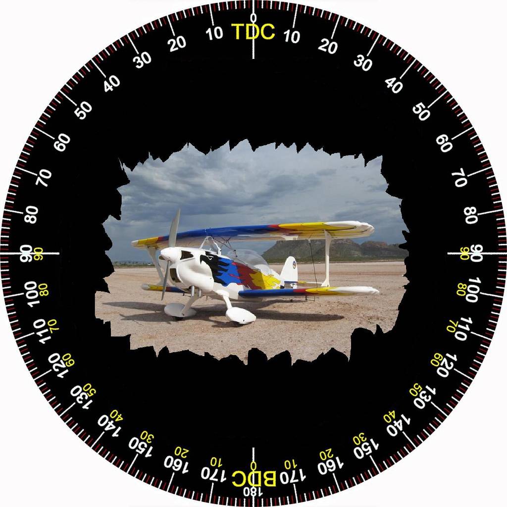

I have a professional one around here somewhere but . . . .
I print off the CH one off the internet and past it onto some 1/8" luan door skin. works just as good.

Here is a nice one. My thanks to the original poster of this one, It is nicer than I could have done. And my apologies for not capturing his name.

That one will get the job done too.
This one is great for plotting the port timing where you need the whole circle.
You can cut it in half for ignition timing if you want to save plywood.

That was me. The shot is of my Christen Eagle, taken in San Carlos, Mexico. (It just happens to have a Homelite 30cc in it.)
Glad you like it, I have sent it to numerous members of the forum here.
