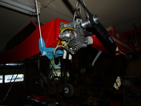

Hi, I just finished installing my engine conversion (poulan 46cc) on my plane, I set the timing 28 BTC, or very close, it is a RCEXL , when I flip the prop, it does a back-flip and wont start, some times it will but my arm has almost fell off. Do you have any suggestion on what I can do.
Thank you.
Pedro V.
Old 06-10-2012 | 05:10 AM
My Feedback: (54)
Posts: 70
From: Ithaca, NY
Default RE: EI Timing for conversion engine
Thank you.
Pedro V.

The ignition triggers just as the magnet leaves the sensor. If you turned the crankshaft in the wrong direction when setting the timing, your timing will not be at 28 degrees before top dead center. It will be off 12 degrees total advance if you turned the crankshaft opposite the direction of normal rotation.
That means that in starting mode, your timing is probably some 8-10 degrees after Top Dead Center depending on your method of setting the timing?

Hi W8ye, I know that I right with the engine rotation, maybe I'm a little off with the BTC, I have been doing some research and the people say that in the BCT always has +/- 5 degrees on play.

You want Top Dead Center not bottom dead center
