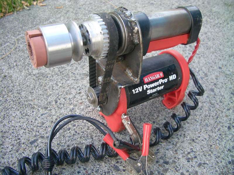

Just thought I'd share what I use. It'll turn over all of my gas conversions up to 48cc but still has the rpm to start glows as well. My next step is two 7-cell car batteries for 16.8volts and cordless.

Is that the timing gear off a Pinto? (Just kidding.) Where did you source the parts?

I got the pulleys, belt, and bearings from a bearing supply house. They were for a geared-down Ryobi project that went south(plane too heavy). So I cut apart the drive assembly and built this starter. This is the second starter of this variety. I burnt up the first direct drive one on the Ryobi so I realized I needed a reduction. Works very well.

Outstanding effort.
