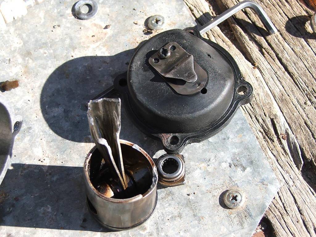

Having read various posts on the the strength of ryobi conrods. I was flying my spad the other day when the engine went bang ,clunk ,clunk and stopped ,after making a dead stik landing I thought the engine might have sucked my butterfly screw in and done some damage which has happened before.After taking her back to the shed I pulled her apart and found that the conrod had let go. I always thought that the conrod was strong enough to handle just over 7000 rpm but won't trust them over 9000 rpm. This engine would have been doing between 5000rpm and 6000rpm when she went bang.Then I thought for a bit and that this conrod might have come out of a crashed engine and what happens when you go in nose first the crank shaft gets pushed backwards into the crank case and bends the conrod near the crank pin and I might have recycled this piston and conrod.
The only damage was to the piston,conrod,reedvalve.
Any way I found it interesting as I have plenty of spares and the engine is back in the air again.

Every time I look at one of those Ryobi rods I am amazed that they hold up as well as they do...

I don't think a crankshaft and rod can be made any cheaper than this.

Looks to me as though something got in the bearing and locked it up at rpm?

I have repaired many of these 31cc engines in string trimmers and leaf blowers, and most of these were from the 1990's time frame. One thing I always noticed was the reed stop is extremely close to the con rod big end. All had rubbing on the reed stop by the con rod until flakes of chrome came off the reed stop then, more metal was torn from the reed stop, then the engine would lock up from the metal fragments getting into the crank bearing.
I solved this problem by using 2-3 gaskets under the intake block and sealing well with permatex ultra grey. I wonder if this may have contriburted to your rod failure. I found it impossible to remove all the minute metal particles from the bearing when this happened, so a new service crankcase would be installed (along with a new reed assembly, and careful check of the rod bearings). My old service manual for this engine lists some brush cutters models maximum rpm as 8,800, so I feel that the rpm isn't the culprit.
MTD sells an improved crankcase now for ~ 60-70 dollars, that is stronger than the older types, but you'll need the matching flywheel and module as the woodruff key location has changed.MTD-753-04328 (long shaft). Yes, it's not worth the time or money actually, but I really like this engine so I repair them when I can find one. [sm=49_49.gif]
