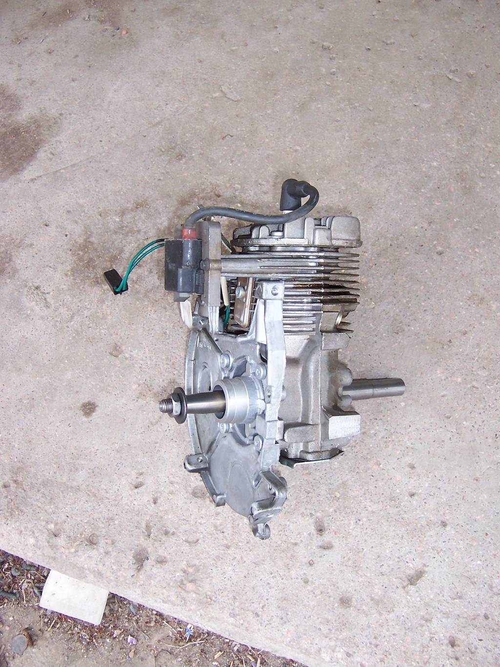

I scored a used snow blower for $20 and it has a 60cc Tecumseh engine in it that I think will make a descent conversion with a little work. It runs very strong and not even broke in yet.
Anyone done one of these yet?
It has 2 piston rings and lots of compression, I can still see the crosshatch pattern in the cylinder wall and the micro-grooves in the piston rings. It has ball bearing in the front and a "cartridge" bearing in the rear (I'm guessing a needle bearing)

Looks like a worthwhile subject for conversion to me.. I have done similar engines from an MTD 4.5 horsepower 2 stroke and it worked great..just replace the carb with a crankcase pulse type and give it a try. The adapter for the carb can be a bit of a challenge but I'm sure you can make one. Take the pulse direct from the crankcase and you should be fine.

Got some progress done on it.
I cut the back part of the cank shaft off and trued the end in my lathe. I machined all the exess material off of the front plate.
I am going to test weld an extra piece of the crankcase that I cut off, If I can weld it I'll machine the carburetor mount and make my own so it's not so goofy to deal with. Or I'll just machine a block to fit this goofy mount out of PTFE.
