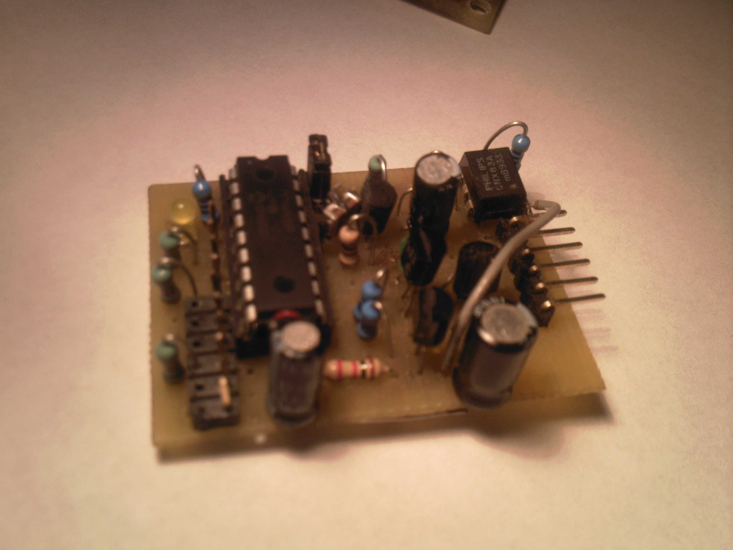

Hi. I have build a timer board and usb to ttl module. But i'm experiencing problems Can I programm PIC (put hex file into memory) using this usb to ttl module or I need other programmer? Here you have pic of it

You need a pic programmer to program the hex into the pic.
Old 08-03-2011 | 01:43 PM
  #524
Joined: Aug 2011
Posts: 10
From: Zywiec, POLAND
Default RE: Complete new CDI - website open
So I can't use this usb to ttl module like this man right herehttp://www.swharden.com/blog/2009-05...on-via-max232/ To programm PIC ?
Old 08-03-2011 | 02:01 PM
  #525
COM
Joined: Jun 2009
Posts: 396
From: Ga, GA
Well if you use a bootloader then you can program the pic with a serial connection.First you have to program the bootloader into the pic.So if you have a pic programmer then you can just program it with the original hex.
