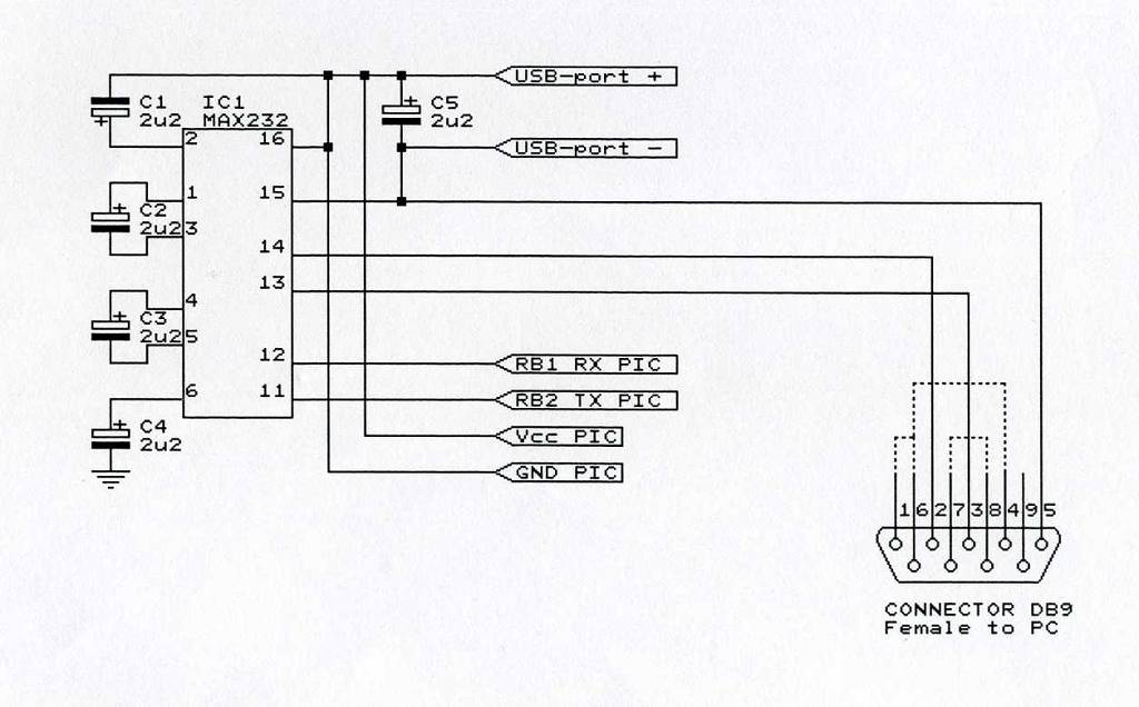

Hello Atam. I have never used either of those rs-232 interfaces you show in your posted message. Why not try the USB powered version on the website?I use the USB powered version and it works perfectly. Easy to build and it's reliable. John

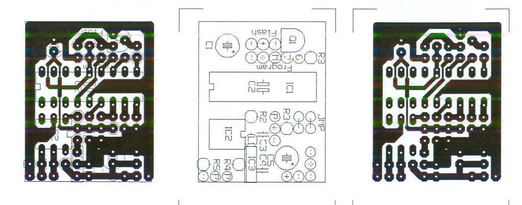

Atam... I'll try to transfer the pictures here..
Note the polarity of first and last capacitor on the layout!!! Reversed from the middle 3 capacitors.. and only 3 wires going to the DB-9 connector to the serial port of the computer... Also, it needs a usb port power connection to the computer usb port..not from the serial port !!!
John

Atam, the ASM code is not for the newest timer board but for the one before it.
I'll post a picture of it if I can. This is the schematic and board positive & layout for the old timer board Nyemi's code works on.
John
