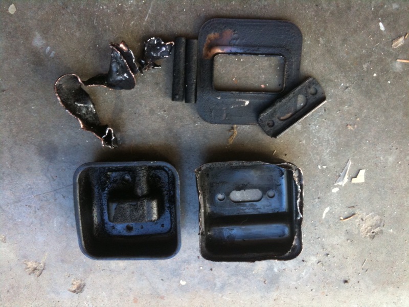

I got most of the plastic housing off that Ineed to, and tried to finish gutting the muffler.
The baffle box where the exhaust goes out from the muffler is stuck on there extremely well and I am having trouble getting it to come off.
Ibent the seam a little bit getting the 2 peices out that are in the middle, one of them came out very easily.
The other one not so much, I had to cut one of them to get it to come apart.
It is nothing I can't fit with a little tlc when I put it back together.

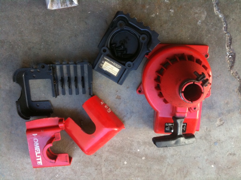

Here is some photos of the motor, muffler and plastic housing.
As you can see the baffle is still in the muffler it is very hard to get out, not sure how I am going to get it apart.
Any help would be appreciated.
The plastic housing with the peices beside it that I cut off, still need to cut a little bit off the crank case cover.
The motor looks good it doesn't have any scoring and looks to be in good condition.

to get the last part of the inner muffler out, drill out the little spot welds carefully so that you don't go through the other side, that's how I've done it before.
you're going for an air cooled boat engine I'm assuming? one the one I set up a year ago that I haven't finished yet (got my airboat going instead) I trimmed the pull start housing similar to what you did but I left more of the ducting for the cylinder but it'll probably be fine.
My Feedback: (16)
For the baffle in the muffler I used a small die grinder and ground the spot welds down until the baffle came loose. Sort of like what the previous post said but he used a drill.
If it is a cad plated muffler, the cadmium will have to be removed where you are going to weld. I did two. one was black and the other was cadmium.

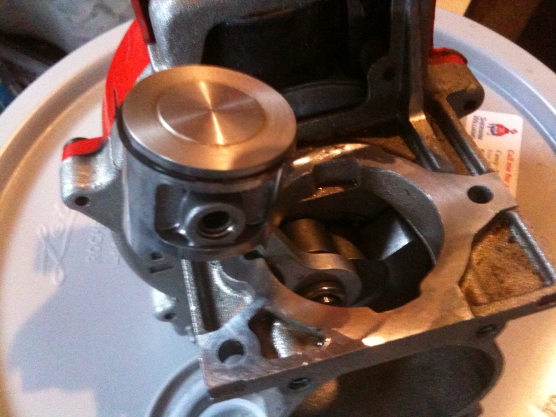

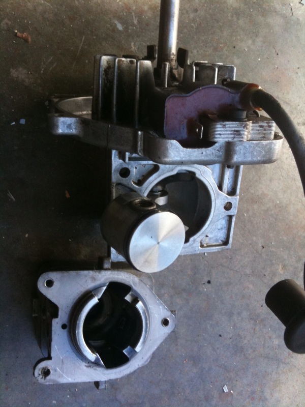

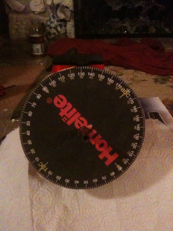

Today I took apart the other engine that Ihave which Ipurchased from someone else and found out it has more modifications then Ithought.
The piston looks like it has been machined down on the top and on the bottoms? I am assuming this is done to lighten it as well as make the squish clearance adjustment needed for the top. Also it raises the compression?
The crank case has been milled down I am assuming to make the squish clearance smaller?
Does it look like a decent job has been done? I did not do the work myself and this is the first modified motor I have seen.
I have not yet had a chance to check the timing but I plan to in next few days.
The engine still has the bar between the exhaust port but both ports have been modified as well.

The cut on the piston doesn't look completely like the book to me?
I remember there being a squish band cut around the perimeter with this being blended in a dome radius back to the center. i guess there are many ways to do it?
The skirt on the exhaust side is critical because of sub piston induction possibilities because the cylinder base or the case top surface was cut?
The skirt on the intake side controls the timing/duration of the intake port from the carb
As a result all the timing intervals need to be rechecked? Seems like we talked about all this on the other engine?

The book?
You tell me I am only guessing on these mods. I am still new to all of this. I am sure the things you are saying are correct seems from what I have read....
Ihaven't checked the timing on this motor yet I plan to.
This is the first time I have had it apart since I purchased it.
I will post my findings as soon as I have some numbers.
I was hoping to use this motor as a sort of guide to help me with my stock motor I plan to mod.
I have started the motor once and everything seemed to run fine I only had it running a very short time though....
Yeah, check the port timing numbers to see where they are at. Seems surprising someone did this much work to the engine and didn't do the "Pin the ring" mod. I imagine you have read about that. You send the piston to Frank Bowman, and he puts a pin in the ring land and makes a special piston ring for it. Then you grind the bridge out of the exhaust port. It is a worthwhile mod.
I am wondering why they cut the piston skirt. Lowering the cylinder raises the intake port timing. Cutting the piston skirt raises it even more. Not necessary usually for our applications. It is possible this engine was intended for very high rpm operation for a car or a boat. Checking the timing of the ports will tell more...

All these Homelite mods were popular 10 years ago but is hard to come across now
I put all the jibberish together as you cut the edge of the piston down to leave 100 thousandths between the edge of the piston and the top of the ring land. This cut goes in 400 thousandths. Blend into the uncut portion taking into consideration the shape of the dome in the cylinder .
Now place solder in heavy axle grease in one quadrant of the piston. Assemble the jug and pull the engine through a few times. Measure the thickness of the solder. Repeat for the other three quadrants. You want to cut the cylinder base to get .020" squish band clearance.
Then onto port correction?
I = 140
E = 160
Transfer = 124
Blow down = 21 <style type="text/css">p { margin-bottom: 0.08in; }</style>
It is the difference, in rotational degrees of the crankshaft, between the opening start of the transfer port and the opening start of the exhaust port.</p>
Crankcase back plate volume reduction? to .020" clearance with crank

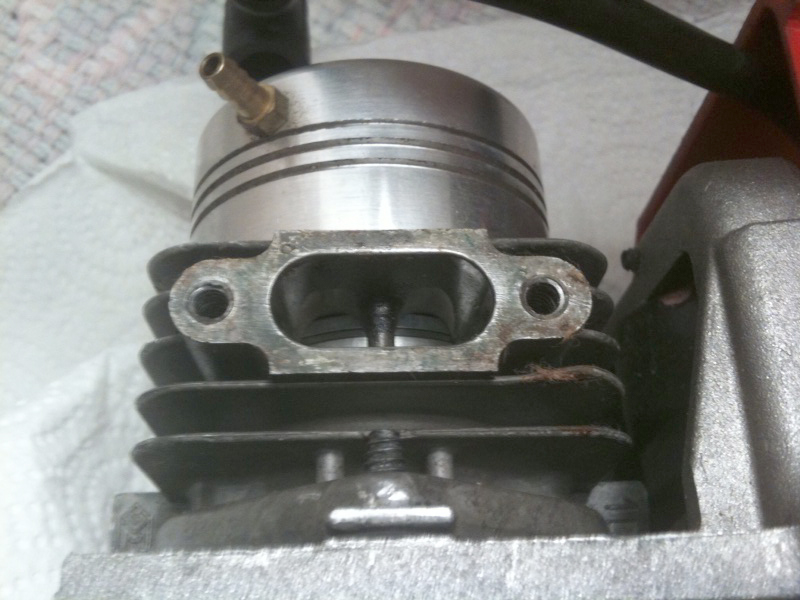

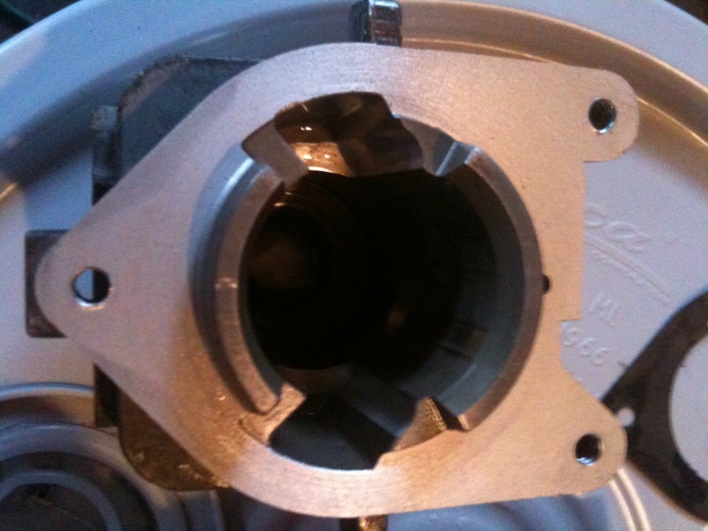

Joined: Jul 2010
Posts: 225
From: Portland, OR
<hr size="1" style="color: rgb(209, 209, 225);" /><! / icon and title > <! message ><div id="post_message_421098">Ok so I checked the timing and here's what I got.
148 intake
164 exhaust
I tried to check the transfer timing but not sure I was doing it correct.
Blow down is 21
Here are some pics of the exhaust and intake ports.

148 intake
164 exhaust
Blow down is 21
I am not sure if the crank case has had any reductions, it definitely hasn't been stuffed.
Thanks for the thread I will have to read it all the way through.......</div>

I want to make sure I have the piston ring in the right position I think it was off when I got the motor. Should the opening be perpindicular to the ports?
Do you think it would be a worthwhile thing to remove the bridge?
I have been told it would be a worth while mod. I am wondering if I can do it myself.
Iaslo was told I would need to radius the edge does this mean to just smooth it out a bit as well as pin the piston?
