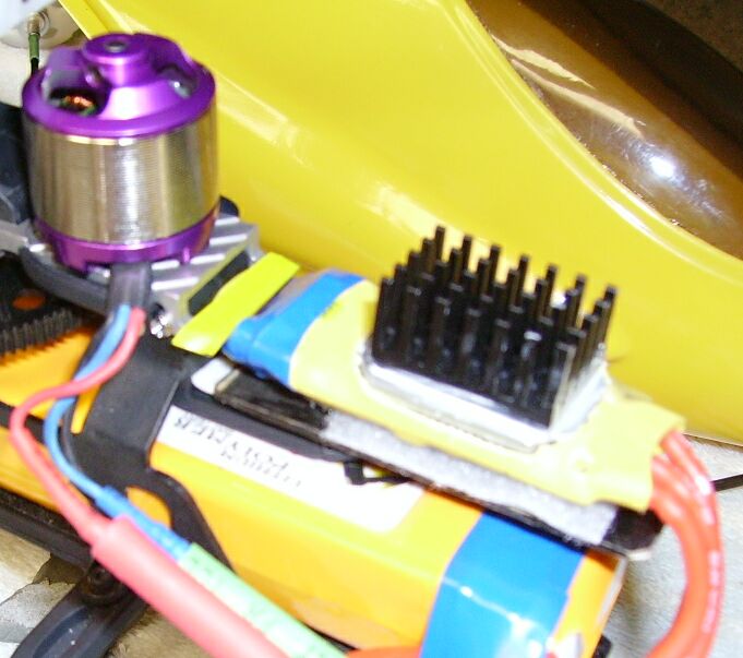

If your running a king ll and a 3800 motor and your only hovering you shouldnt have any problem with a hot motor or esc or battery. I run my 3800 with a 10t pinion (I like lots of torque) and that allows my motor to loaf with plenty of power. I still can hover at half stick or a little less if everything is linear and nothing gets much more then warm. However I bumped those settings up so they all happen at 3/4 stick, 40% power and 75% pitch. I may be behind the pitch curve but with my low gearing it's stable and nothing overheats or even gets warm battery is warm but not hot after 10 min hover. Most of the heat generated by the esc is from dropping the 12.5+ volts down to 5 volts for the servos etc THAT generates a lot of heat. Although it will not give you a longer flight time (ok so its like 15 seconds longer
) you could add a external stepping bec and that would solve the heat problem on your ESC if you want a Hobbywing bec will put you back about 10$ or so. If your really into cooling things you can trim open the top of your ESC and mount a heat sink on it and that will NEVER even get warm!
pic below.
BTW its mounted with Artic Silver 2 part heatsink compound, its like a epoxy and is commerically used to mount heatsinks to irregular shaped components mounted on boards. It's permenent! Pricy though at about 10$ for the two small syringes.
) you could add a external stepping bec and that would solve the heat problem on your ESC if you want a Hobbywing bec will put you back about 10$ or so. If your really into cooling things you can trim open the top of your ESC and mount a heat sink on it and that will NEVER even get warm! pic below.

Hamid the pic I am showing was for the heat sink on the ESC. That is kind of a older pic as that motor was a 3900 )with a 10t pinion) which is only 26 mm in dia.
I did the same as you did on the 3800, shaved the base of the motor as it is not cut at an angle as most motor bases are and I didnt want to cut into the frame at that point. Also I run a extra motor "Pad" to raise the 3800 motor up a little higher on top of the Extreme mount. For the pinion I just position it a little further down the shaft to make full contact with the main gear.
There are a lot of variables for heat but with that 10C batter and considering the motor can pull about 20C you will find a larger C battery will run considerable cooler. I notice that my older 1500 mah 15C battery runs a little warmer then my 20C-25C 1500 mah battery but I am measuring heat with my fingers (1 is room temp 5 is warm and 8 is OUCH damnit! anything over that is a juggleing act).
I think somewhere I said that I run a ESC that has a built in UBEC and it barely gets warm to the touch as most heat is generated by the BEC side of the ESC dropping the voltage down to the 5 volts.
