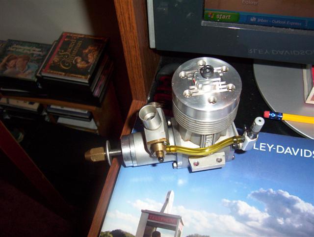

Hey Earl, on the other end of the suck, squeeze, bang and blow cycles a lot of fuel would simply blow away in the wind. My Fitzpatrick .61 is timed for 17,000 rpm, while it will run as a Diesel it requires a lot of fuel and a small prop. I sleeved the carb to try to reduce the blow back but it just limited the performance instead. The head by AJC is a work of art looking nearly identical to the glow head.

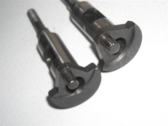

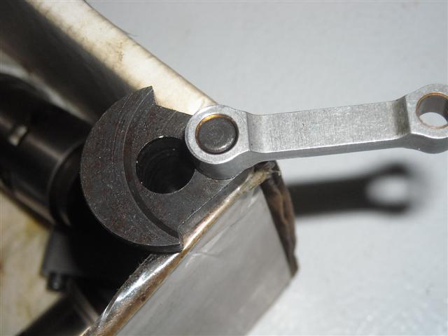

Max, I know why Bob said that, I bought a new crankshaft for a big case .40 about 10 years ago and they sent me the crank for a small case .40, the big end rod bearing had about 1/16th" clearance of more. The crankpin on the crank they sent me was tiny by comparison.

The small case Fox .40 would not work good as a diesel because the crankshaft is too small, especially the crankpin.  But the large case .40 would work good as it has a much stronger and larger crankshaft in it. The large case .40 engines were also made in the .45, .46 and bigger .50 sizes too.

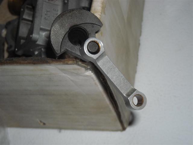

Earl, I still have that small 40 crank, Sharon sent me a new large crank for free. Picture #1 is big 40 rod on small crank pin, picture #2 is big rod on big 40 crank, picture #3 is both cranks. rod on backwards in the pictures, sorry.
