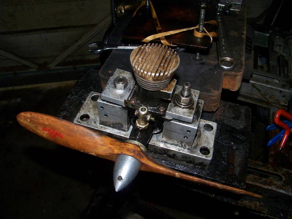

GOT IT TODAY very stiff on turning hit with some WD40 a rinse insidewith some davis abc fuel it came with a topflight 10 inch pitch not known stuck it on the bench about 10 flips and a very loud bark a few more flips with some davis fuel and ran for a few seconds loud sounded like an AK 47 it needs a needle valve assembly and a rear gasket between tank an crankcase, that I can make up I would guess any c/l needle assembly would work very very stiff crank and rod ok no slop in either would ne nice to do a real run will have to scout up a drone needle or replace the whole thing, its been sitting for about 60 years
one of the extra crankcases has an intact c/l fitting so if I can find a needle will be ok

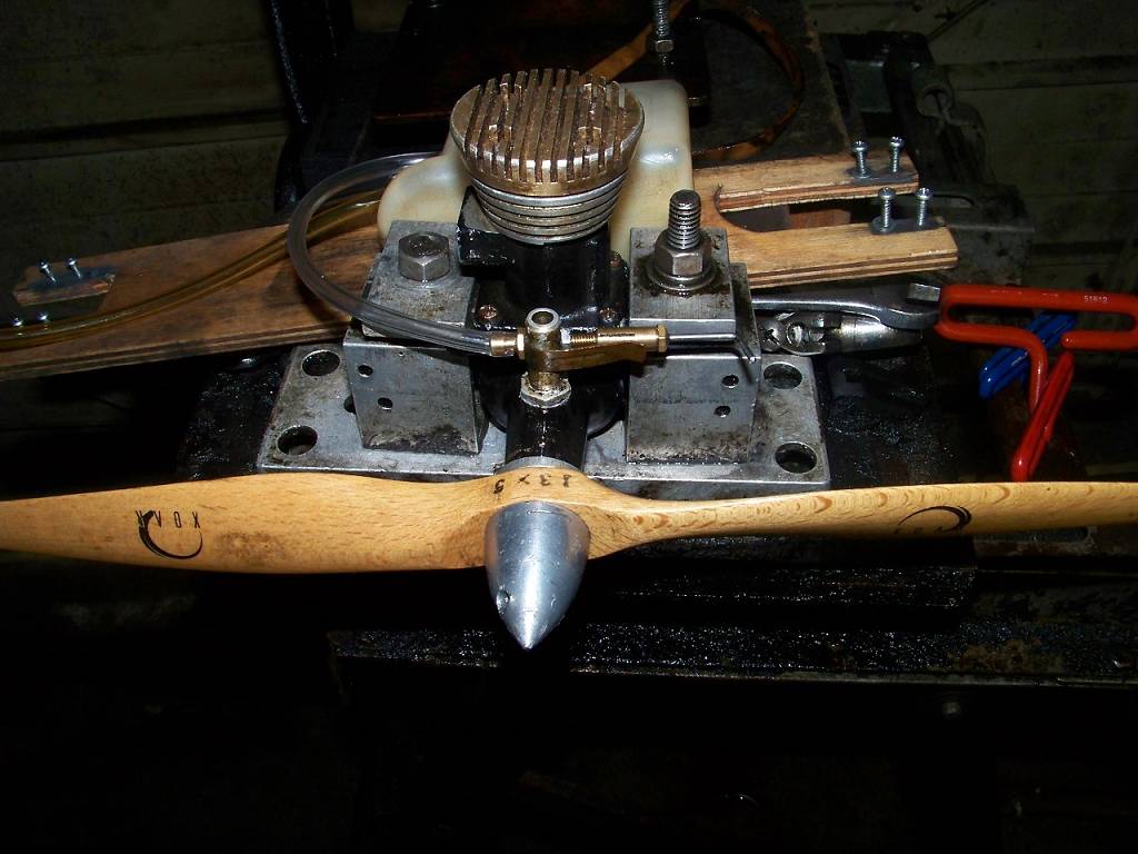

Hi Martin,
I've been playing with, and flying, fixed compression for decades. Could I make a few respectful comments...
1. I've read all sorts of conjecture concerning fuels... There'sno need to get bogged down in assessing variousfuel mixes... Just make up the recommended Drone fuel 75/25 (this was the original Micron recommendation, in 1943). This fuel will be OK in any temperature between about 20°C and 30°C. Below 20°C (unlikely in Fla.), you may need a bit more ether (80/20 is OK because inthe lowerambient temperatures, you won'tbe overheating). Conversely (andmore likely in Fla.), above 30°C, if you don't reduce the ether content slightly, you'llget pre-ignition (combustion will occur before TDC), which results in very rough running and vibration. IMO,this is why some people find that Drones vibrate, they just have too much ether in the fuel. So in the high temperatures that you have in Fla., in summer, you may well do better with 60/40 fuel, or even 50/30 with 20% kerosene. Personally, I always use 75/25 and just avoid using the engines in very high or very low temperatures (otherwise, you're continually messing around changing things).
2. Your NVA issue is a non-problem. Just borrow one that fits (no air leaks and with the hole roughly in the middle of the venturi) from another engine. In the States, I think the old Austincraft "universal" NVA would be an excellent solution.
3. Concerning the photo you've posted. If you've never run that engine before, and you're not experienced with fixed compression, then the prop on the engine looks to be far too small. To run a Drone/Micron etc. for the first time, always start with a 14x6 wood prop (another Micron and Drone recommendation!). When you get used to the engine, then you can start to experiment with other props. TheTopflite 14x6 wood is great for flying old timer RC so, for me, there's not much point in playing with smaller sizes, it just complicates the issue and would only be relevant if you intend to fly CL...
4. One potential issue is that we're communicating internationally, and between very different climates. Fixed compression diesels are very "temperature dependent", and opinions that are valid in one part of the world won't necessarily be valid elsewhere. In the warmer temperatures of the southern US, there shouldn't normally be any problem running fixed compression. However, in cold climates (Alaska, Norway, etc.), there probably won't be many days in a year on which a FCD will start easily and run well... One "advantage" of being in Europe is that we're half-way between these extremes. We get both types of climate, so I see those changes in running characteristics, twice, every year!
Brian

HI Brian .THX for your advice on this one I was surprised when I took it out of the box and saw the small 10 inch prop with it will go get the larger one biggest one I have now is a 13x6. Back when I was a kid the drone was my first and only engine I had and did make up the 75/25 fuel mix, it brought back memories never an issue with it as I recall over many years an moves it sadly went missing martin
the small prop wth it appeared to be a pretty high pitch maybe a 10x10?? or higher pitch?? if they made them back then
I was out of this hobby for decades when I started again my first engine Irvine 40 diesel and then of course other diesels never bought a glow battery till I got some 4 strks
my davis conversions contrary to custom never saw glow fuel no issues ever it just took a few more tanks to break in no diifferent glow fuels plugs to match etc

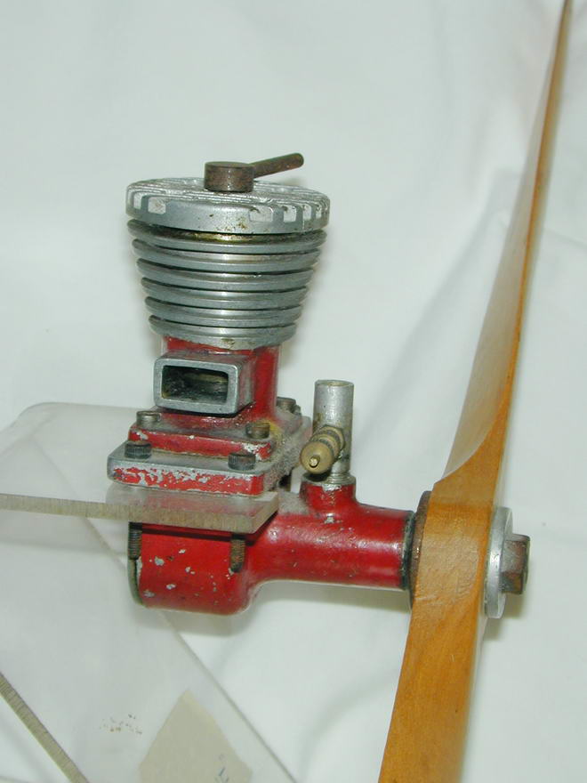

Sometimes the adjustable compression diesel heads show up for auction of for sale. Or one can make one too.
and they had glow fuel heads too with a threaded hole for glow plugs.

If you can locate them, the old Austin Craft needle valve assemblies look the most authentic as I think they bought many units from them too. They made jillions of those things and they pop up on the auction sides pretty often.
But you can use many other needle valve assemblies just fine too. OS, Enya, Fox or others for example.
Now then if you have some types of needle valve units and the center needle is missing, it is pretty easy to make one and solder it back into the needle holder cup. I found a piece of mild steel rod that fit into the needle spray bar and chucked it up on my drill press and used a file and some knife sharpening stone to shape a needle point and taper on it.
Here is where I did just that myself as I had received this engine without the needle, but I still had the needle holder.

well backplate issue solved used stretched an O ring over insert put on backplate great seal dumped the back attached tank will use external one-needle valve issue next martin
If I can find an original needle set to go rest of set up ok

Well after some piston and liner swapping finally came up with a combo got got us some fair compression also installed a PAW c/l needle assembly in the Drone venturi
put on a 13x5 XOAR prop primed hand flipped , ran for a few seconds off the prime Davis ABC mix will hook up the tank Fri or Sat and go for a run curious what the RPMs will be on this prop, the original tank is not mounted just the insert back and with the backplate, clamp gasket was shot so used a nitrile O ring seems fine martin
