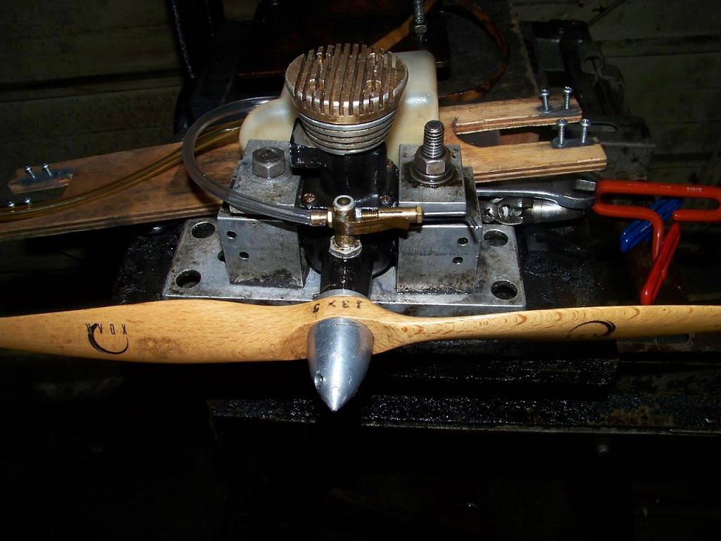

Ok guys its on the bench ready to go will fire up tomorrow fitted as I said before with a PAW needle valve assembly prelims look good look nice draw of fuel on choking
no leaks head or back plate martin

It is looking good. Do let us know how it goes,

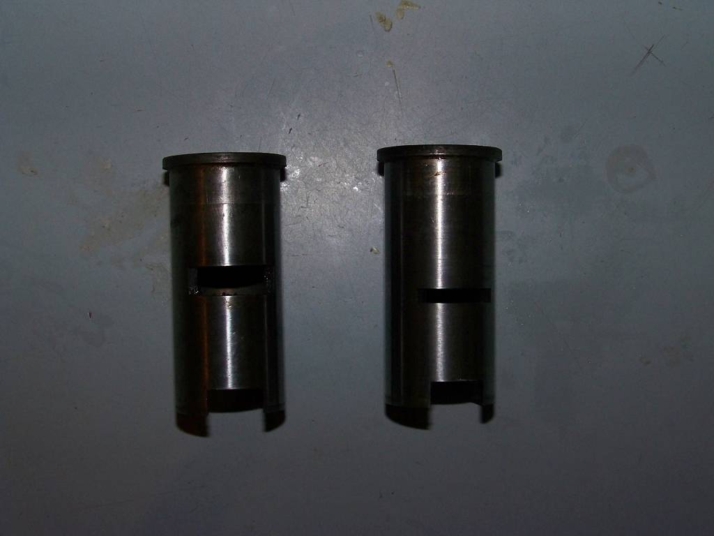

Made up the 70/30 drone mix and still a no go a few pops quite a puzzle, compression seems ok, new PAW needle assembly, just for kicks pulled the liners on the two cylinders i had
( piston to liner wear bad compression we tried them. just as an interest pix here they are large port of course exhaust small one (only one 180degrees from exhaust)
is small and directly in line with top of bypass bulge on cylinder casting but it works well you would think not a good breather but it is martin
toying with the idea of having them chromed

I am concerned that you may not have Drone cylinder sleeves there. I do not remember mine having a lip on the top of the sleeve.
Mine all are simple straight cut cylinder sleeves with no lip on the top. There is a shoulder down inside that the cylinder sleeve butts up against, so it doesn't need a lip. But maybe its my memory mixing things up. Here is a pic of one of mine, Granted this is the BB version. I'll have to look to see if I have a pic of the bushed version someplace too.
The bushed version may not have the shoulder on the crankcase for it. I don't remember now.

Earl I very well have the wrong sleeves which would explain no charge entering the cylinder intake port will not line up right thx martin
mine is bushed not BB also only 1 head have 3 crankcases assembled engine from parts #7523 other 2 cases 2951 and 1399 stamped on them

I looked through my pics but I didn't take a pic of a bushed Drone engine cylinder sleeve. But the pics I did have show a lip on the top of the cylinder so you are Ok in that respect. yeah it is easy to get the cylinder sleeve in wrong. Also the piston as well. There is a cutout or notch in the piston that corresponds to the transfer port. The bottom of the piston skirt matches the intake port on the back. I had to think about it a while to be sure.

EARLE Perfect line up on liner in cylinder piston step 180 degrees around from exhaust and yes the lip on liner fits recess in cylinder. The compression still might be too low for a fire off, this piston/liner best of the lot others almost no compression, lots of wear martin
We did use the 70/30 mix not a poptried a few drops in the MPJET 061 2 flips and screamed like a banshee
will have to scout around for a decent piston and liner
