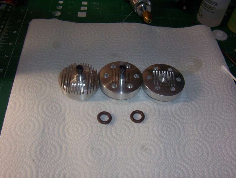

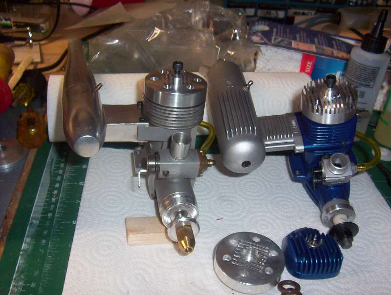

The Fitzpatrick .61 and OS LA heads are here, great quality throughout and beautiful, I can't wait for a warmer day to run them. The LA Diesel head on the left, the Fitzpatrick Diesel head in the center and the stock Fitz. head on the right. Thanks again AJ

Thank you! I didnt know what to cut into the Fitz head, so I kept it minimal... if it needs more fin area later its not a problem to cut more.

Do the heads use a conventional contra piston, or a seal similar to Davis' conversion heads?
They look really nice, by the way.

I use a twin O ring seal. The contra is aluminum as is the head itself (6061-T6). However I use a 1/8" thick O ring (two of them side by side) which I find stands up far better than when I was using 1/16th thickness rings.

Ed, AJ uses two Viton O rings on an aluminum contra, there are two of the O-rings in the first picture. So far I have AJ's heads on an Irvine .25, MDS .78, MDS 1.48, Maloney 125, OS LA .65 and a Fitzpatrick .61, nothing has gotten past the O-rings. Now that I have 3 MDS 2.18's I think one of them is next. The one exception is the MDS 1.48 which has one O-ring but also has a perfect seal. By the way, I have a Tartan 1.34 Cu. In. single coming tomorrow and Mr. Davis is sending a head for it in a couple of days.
