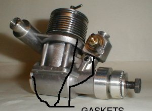

Yes, I know its a bigger PAW, but if yours has been apart, it might be a good idea to make up a gasket set from some stiff paper, so i copied the picture to give you an idea of where to locate the gaskets. Below the needle valve assembly is an "O" ring, check it present and in good condition, the cranckcase back screws into the crankcase and it has a thin paper ring gasket and the base of the cylinder liner also has a thin paper gasket between it and the crankcase. The smaller non R/C engine only has 2 paper gaskets as shown in the picture

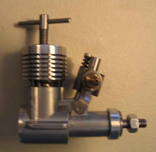

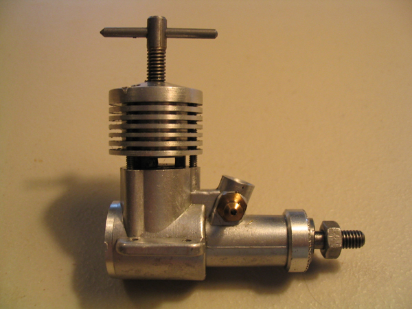

Since you mentioned head screws, I assume you have an older version. Here are some pics. Sorry they are a bit dark.

That's the little beast. Unfortunately we have found that mine is probably unsalvagable. When I got itstarted again the head screws all broke.
Tom

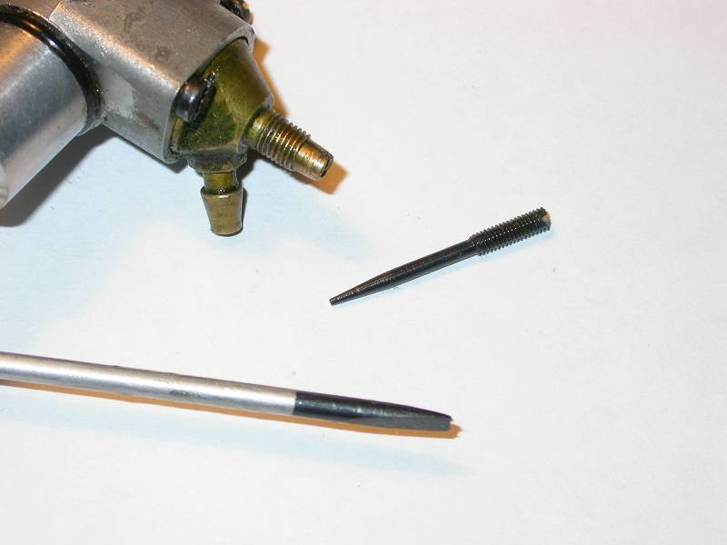

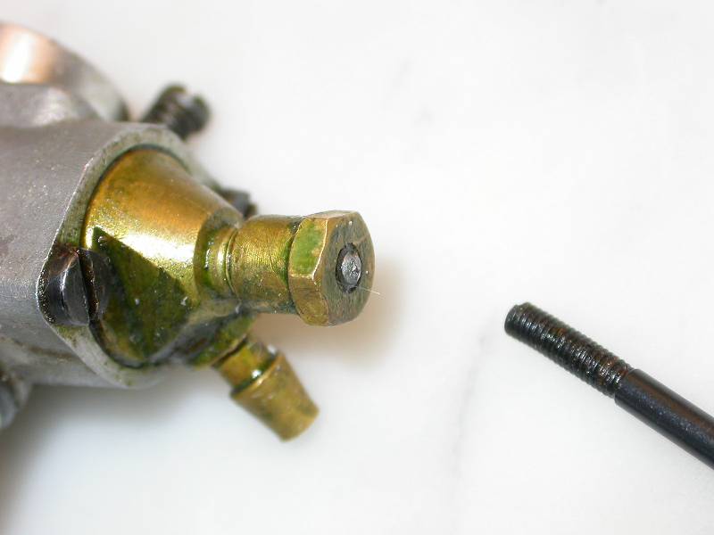

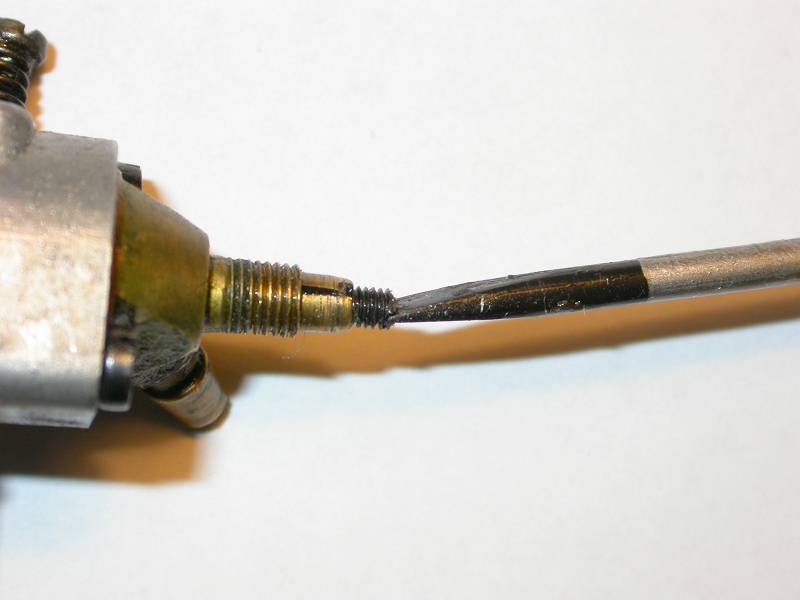

If the screw has broken flush with the top of the crankcase, you might be able to get it out if you can get hold of a really thin file (you probably need .02" or less), and then file a slot across the end of the screw.
You should then be able to remove it with a jeweller´s screwdriver.
You will have to file a bit into the crankcase too, but what the heck, if the alternative is to scrap it?
You can get spare screws from PAW in England.
The photos below show a broken needle that I got out of a ST carb with this technique, maybe you can use it too?
Tomas H.
