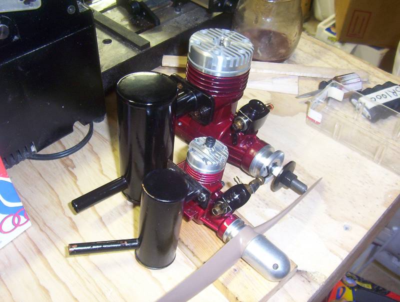

Diesel Friends, I put another hour on the Fox .50 today, it takes that long to a little over half of a 16OZ tank. At the end of the 60 minute run it is turning the Graupner 12x7 at 9,650, this time I used a stock EZ Just carb and stock Fox muffler. I can tell its improved in another way, it now holds compression like an ABC engine, no leak off when slow flipping.

I tried a different prop on the Fox .50 today, a Bolly 13.5x6, to my surprise the .50 turned at a 9,700.
Oh yes, the pipe, it is a Mac's .90 sized Quiet tuned pipe, it does not effect the rpm one rpm. At idle all you hear is swish of the prop @ 1,800 rpm.

David,
This RPM on that prop are a real 1.17 HP...
The 9,650 RPM you saw on the Graupner 12x7 are an even 1 HP...
A gain of 17% in power output does not usually happen, as you increase RPM by a bit over 0.5%... especially when it is running on what is not a tuned exhaust system!
Would you be willing to try both props again; maybe also on the other .50'ish Diesels?
It seems to me Pé's prop constant of 1.45 for the Graupner is significantly lower than it really is, (or that of the Bolly is too high...).

I re-ran the Irvine .53 today with a Bolly 12.5x8, in the first post in this thread it had turned the Graupner 12x7 at 10,121 rpm, it turned the 12.5x8 9,150. I also ran the Irvine .25 with a Graupner 10.5x6 with an AJCoholic head and Davis InCowl Quiet Muffler as pictured and it turned 8,850. Its wearing a Bolly in the picture but I ran a Graupner today.

Can you check how well your AJC head MVVS .49, does on the 12.5x8 Bolly Clubman?
I remember it getting over 10,300 RPM on the 12.5x6...
