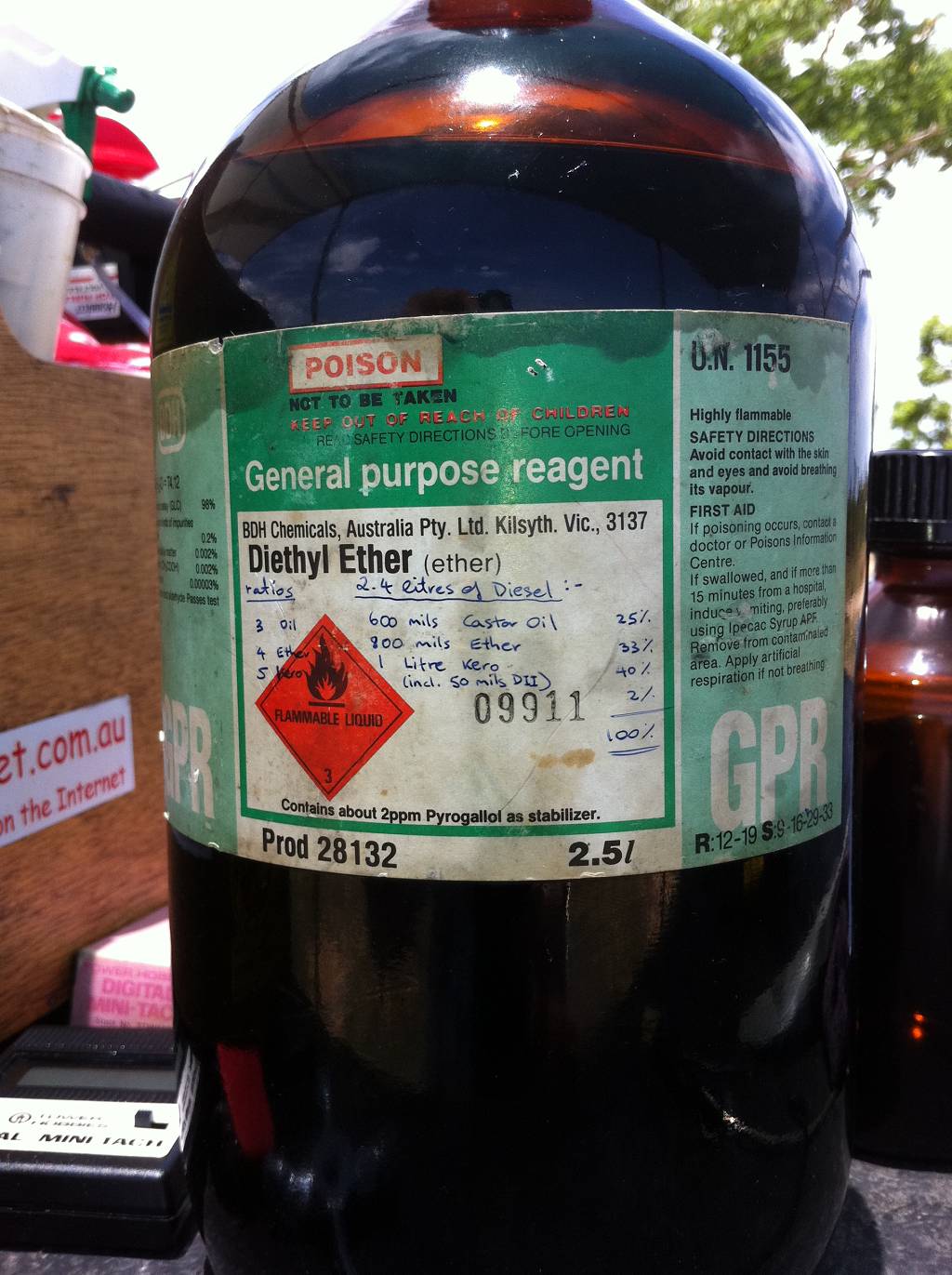

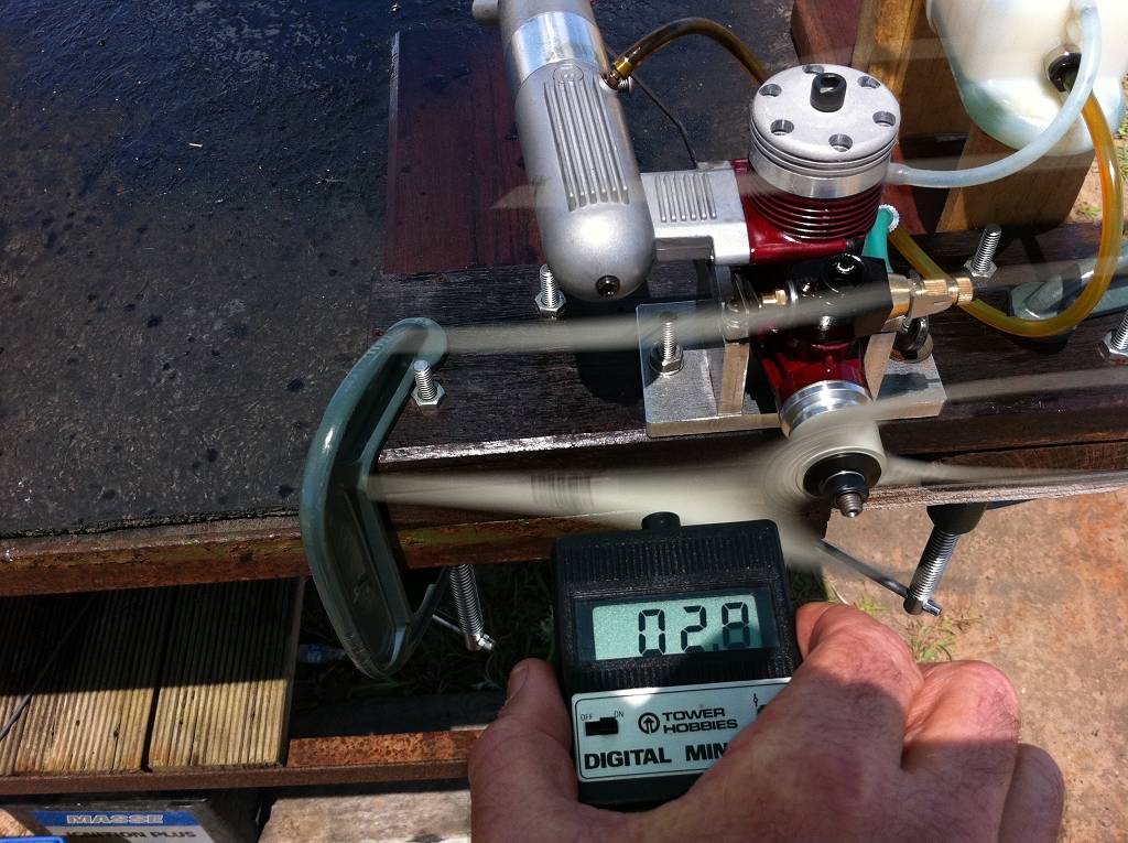

My Irvine .53 Mk I w/ DDD head and Thunder Tiger (Graupner Super Nylon clone) 11.3 x 7.7 grey composite prop

I missed this post Derek, those are great numbers and your head is purtier than mine.

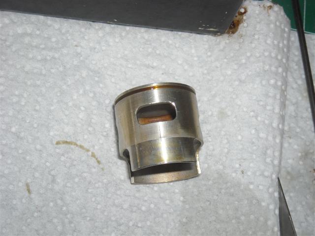

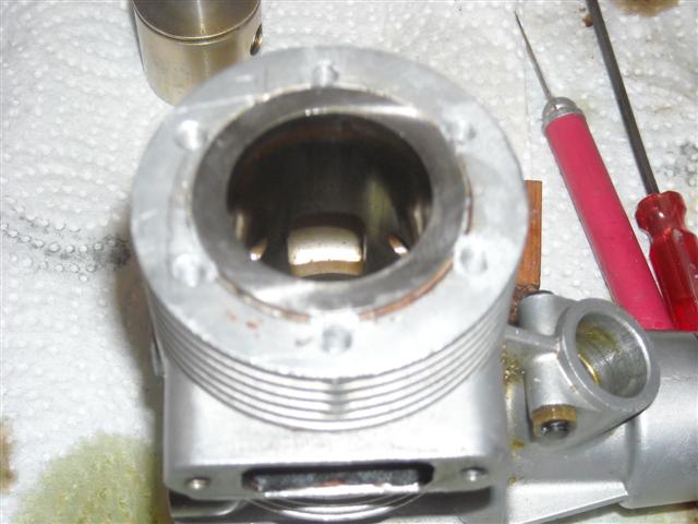

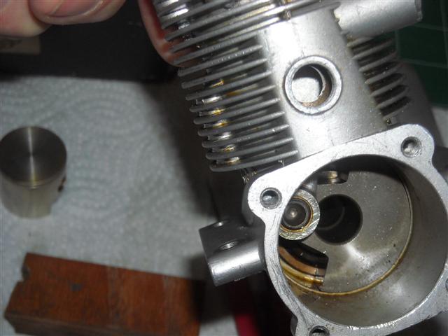

Derek, since this is kind of a generic thread I thought I'd post this here. Recently we discussed the "bumpy' port on the Irvine .40. I've been working on a Webra .91 ringed engine and discovered it too has a bumpy port, its hidden by the cooling fins, it also has the matching port in the piston. This engine is getting a new Frank Bowman ring maybe tomorrow and will become a Diesel.

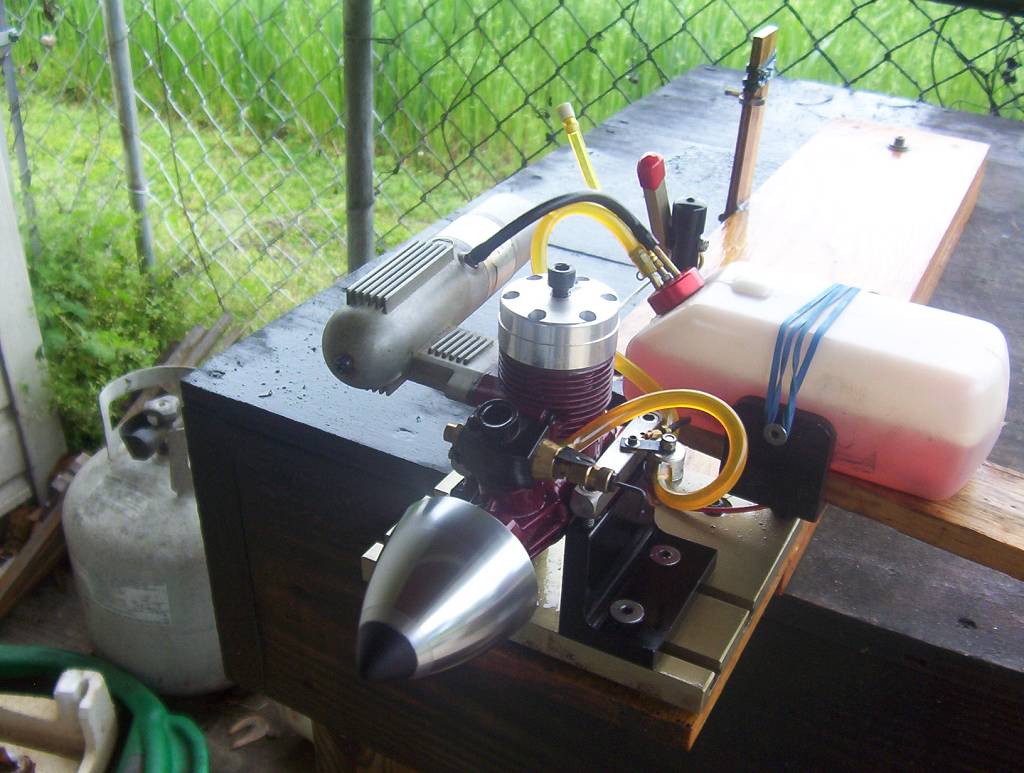

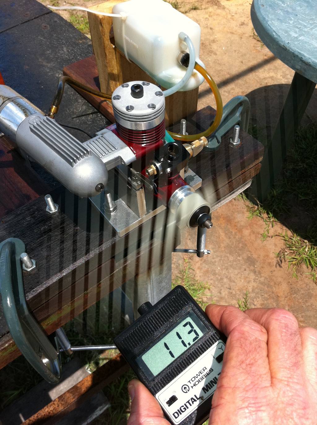

I came down with a bad case of Deezilitis today and cured it by unboxing my old SuperTigre .51. I did something a bit different, I mounted a Davis SoundMaster muffler in lieu of the ST Swing muffler. In the head on shot it is turning a Graupner 12x7 at 9,650, exactly the same as with the Swing muffler. It was 51 degrees and it fired right up flip starting. The fuel is Davis ABC mix.

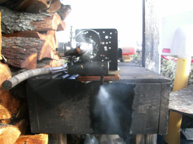

Diesel Friends, I put another hour on the Fox .50 today, it takes that long to burn a little over half of a 16OZ tank. At the end of the 60 minute run it is turning the Graupner 12x7 at 9,650, this time I used a stock EZ Just carb and stock Fox muffler. I can tell its improved in another way, it now holds compression like an ABC engine, no leak off when slow flipping.
