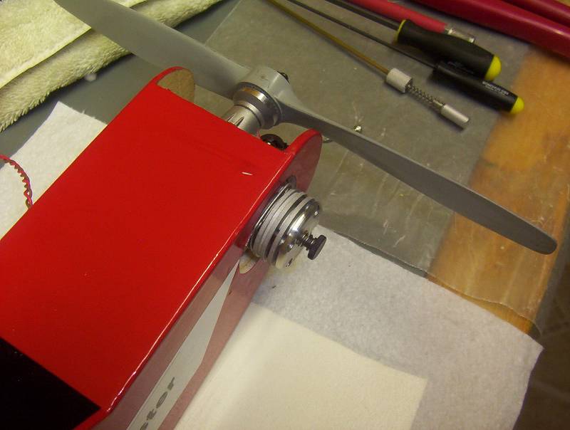

Hobbsy he was doing other stuff to day, personal biz. I did hack out the original fire wall, new one 1/8 ply cut some top and bottom sheeting for access and clearance New one 1 3/4" back from original
this is a well built bird will use a little dubro mount 4/40 caps and blind nuts to secure it/ will use the OS10 from the demised cub 2oz tank at least 15 minutes. THe OS 10 looks good diesel 9x3,4,5 will give 8500 to 10000 range my guess martin

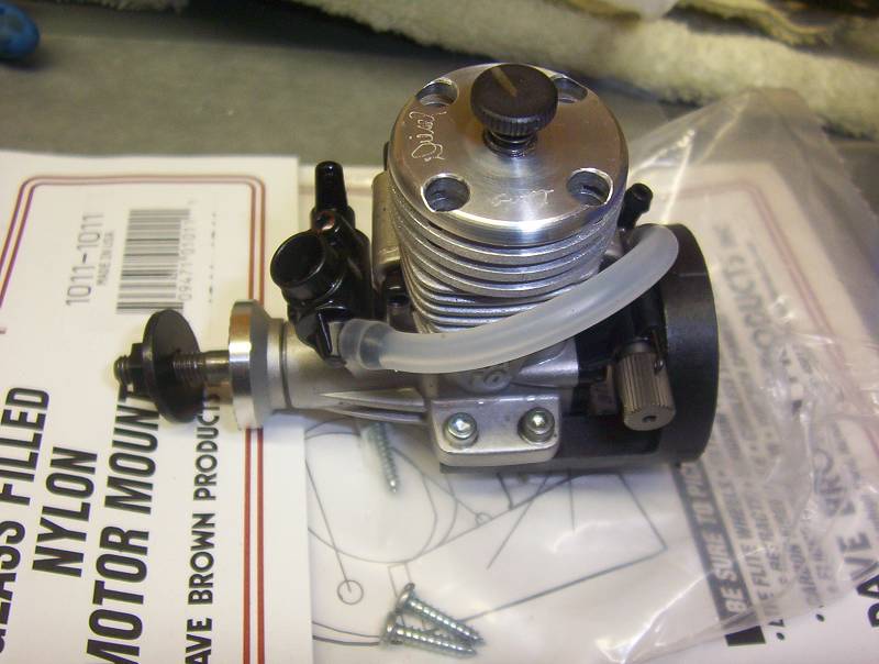

The LA .10 Conversion head came today, its a gem, more later.

That looks nice, a much cleaner look compared to old style top finned one, well more "traditional diesel look"or maybe modern

Martin, the engine mount came today for the .10 so I can accurately locate the firewall now.

I see a knurled thumbwheel under spring tension is used for compression adjustment on this conversion (and I presume other small conversion heads from Bob). Nice touch ... simple and effective. My Irvine.40 DDD head arrived today.

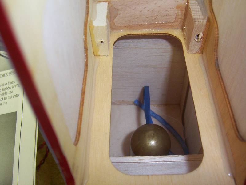

The rest is easy just assembly may swap out to the TT GP10 same mount hayes 2 oz martin

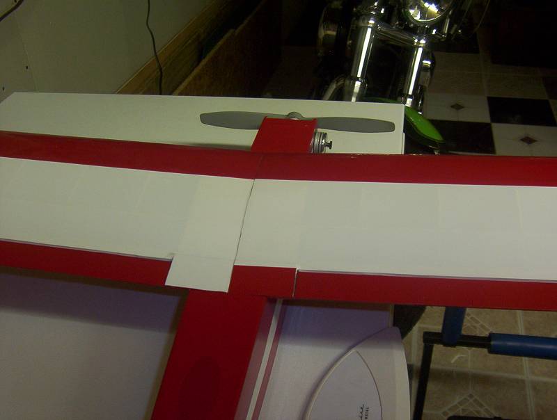

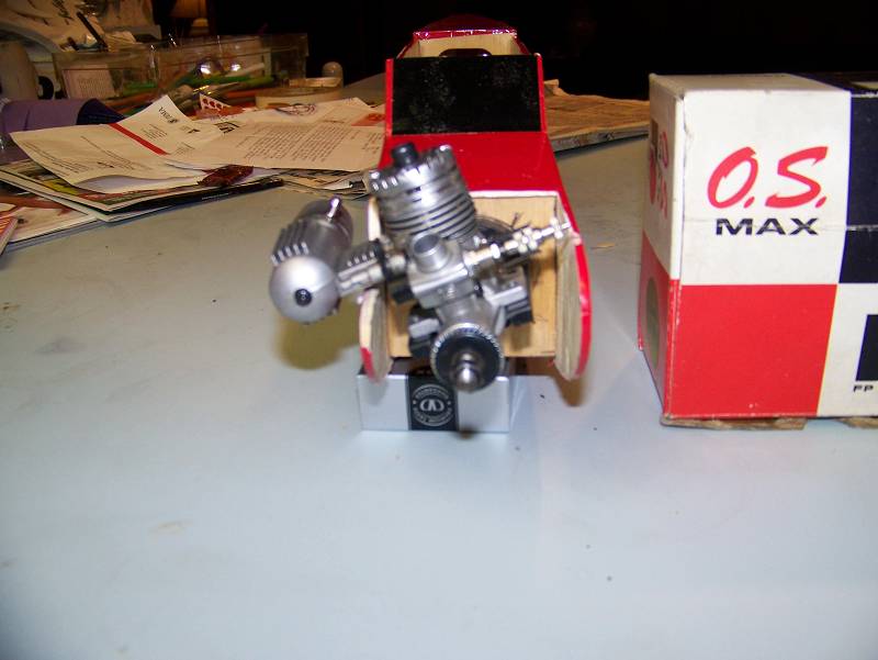

Do you see a trim mistake by the factory? I made 3/16ths hard balsa side reinforcing plates that precisely locate the new firewall, they are held in place by Hobby Lobby's Superphatic. The firewall, 3/16 inch, is 30 minute epoxied on the sides, top and bottom. The engine mount is just barely long enough for the .10. You can see the 5 oz Harry Higley Ultra Hub holding the firewall in place. I used very precise measurements and cuts so the original down and right thrust would be be accurate.

After trying to order aTT10 from thunder tiger 4U and getting a confirmation twice the order vanished a couple of e mails later to Vince who was very responsive via e mail he sent me a fax number to send the confirmation I was not charged just a glitch
in his on line ordering process. I just went down to Bobs hobby center in orlando and picked up an OS10LA
on putting on a prop with no glow plug in the head noticed no pinch smooth as silk so put on the Davis head put on a XOAR 8x6
got a good tight hand hold on the engine gave it a few drops of Davis plane fuel in the carb after about 8 or 10 flips started right up and burned off the prime then repeated off it went in 6 flips. This one will never see glow fuel its going in the VMAR cub #2
remember # 1 is no more.The mini tele will be finished first . will see if I can beat Hobbsy to the punch this time martin

OK Deezel Gents, I'm this far along now, please don't notice that I put the horizontal stab on upside down. I have that exact covering so it's no biggy. I also have to fix the factory mistake anyway.

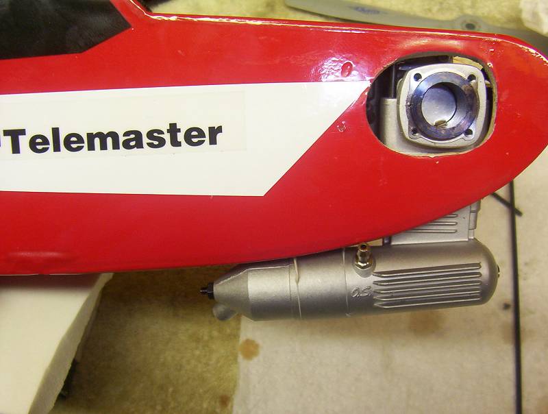

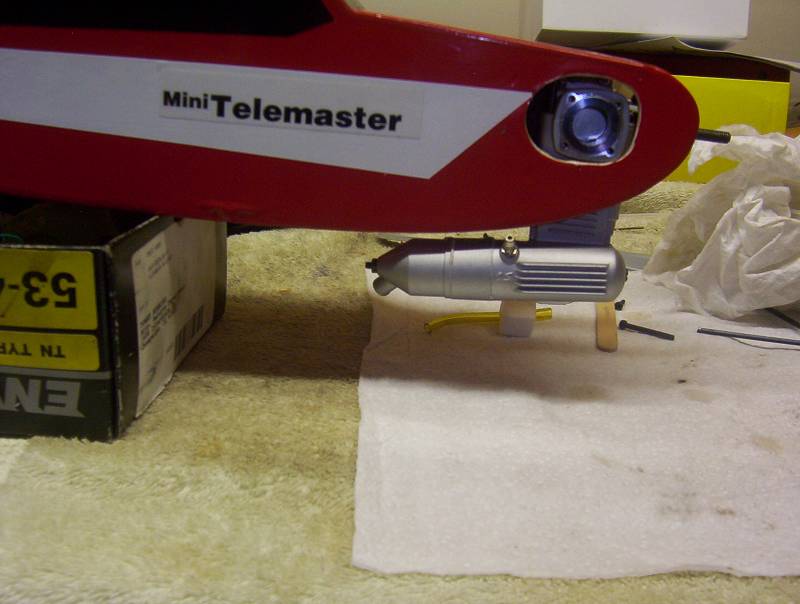

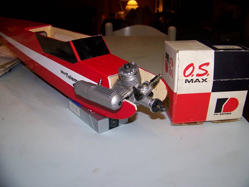

The 7/16th inch exhaust extension worked out perfectly. Do you think the opening will allow enough airflow behind the cylinder, I'm going to clean the hole up a little.

Wide open in the front and bottom I cannot see any cooling issues. I threw most of the plane on the scale engine, wing tail fus, battery but no servos or receiver it should come in under 20 oz at the most dry
Just noticed you said you are going to fill in under the engine If you do just open up a little more around the cylinder. Mine is going to be in the breeze the hatch will be behind the fire wall martin > If you will sheet the top
I would leave the bottom open martin

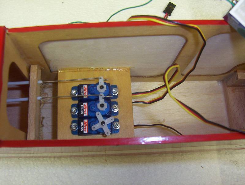

decided to go with the JR micro 35 servos for rudder and elevator 30z torque since have them and I have some sub micros I can use for throttle

Usually you need 2-3 times the inlet area for good flow. In this case you inlet is huge so most of the air will spill over the front. it's hard to say if it will be enough to cool the engine adequately. About the only thing you can do is try.

I think it will be fine, the entire head and about two cooling fins will be out in the breeze.
