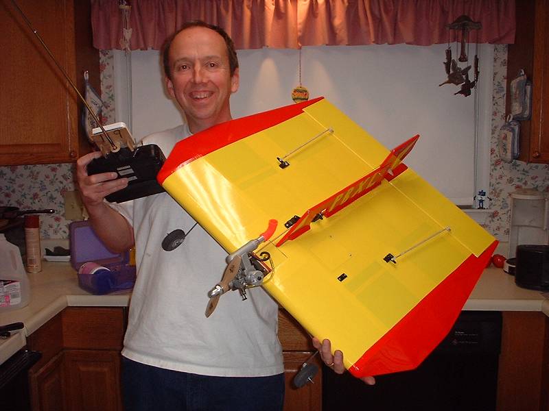

APC 12x4 on a OS FP .40 Davis Diesel conversion head and Davis fuel
11,100 RPM, see the pic on what I want to put it on
