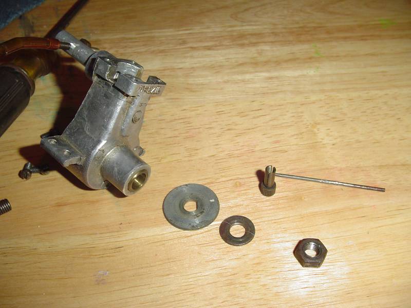

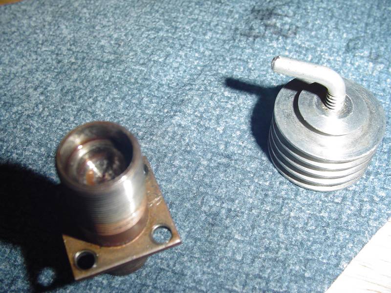

Great info here. Thanks, guys. I disassembled it this morning and it looks pretty good except that the contra piston is stuck in it's bore. I'll probably soak it in oil or kerosene and then heat it up to see if it'll break free. Question: Is the compression screw supposed to be attached to the contra piston? Mine is not. If not, then what keeps the contra piston from slapping up and down beating the other piston to death when running. As it is currently, the piston is hitting the contra piston just before top dead center.
The contrapiston is supposed to fit such that it will go up when you back the compression screw off while the engine is running, but not move up and down with changes in combustion chamber pressure. Diesel contrapistons often come too tight. They move up and down while the engine is cold, but freeze in place and will not move up once the engine is running. Making them fit is a very delicate matter. So far I have not ruined one.

The Deezil prop driver "is" a flat washer with a "D" shaped hole. Another bit of trivia of the Deezil is the die make made a mistake, look closely at the crankcase and you will see that the mounting lugs are not at the same height.

"The Deezil prop driver "is" a flat washer with a "D" shaped hole."
Cool! It looks like I've got the original prop driver, then. This engine is getting more interesting all the time. I sure appreciate the info you all have shared. Here's a few shots of it disassembled. The needle valve removes from the brass collet very easily. I'm supposing that the knurled section is supposed to be holding it in there tightly. The backplate gasket looks to be in good shape. The piston/cylinder fit is pretty nice as well. I just need to get the contra piston unstuck.

I have removed contra pistons by making a 10 inch or so hardwood dowel that fits into the cylinder from the bottom. Place a hardwood piece on top of the cylinder, the dowel into the cylinder from the bottom. With the dowel on a piece of hardwood stirke the piece of hardwood on top of the cylinder. The wood keeps any damage from the cylinder. This should push the contra pistonup and out if needed. A little oil in the cylinder first helps out. I used this on a Mills 1.3 up to a .60 size diesel. Just larger dowel with the larger engines. Jack

I can run it down with the compression screw until it hits the piston but the piston won't force it back up. You have to remove the cylinder and knock it back up with the dowel to readjust it. Other than that, the compression seems very good with everything oiled up. Now, I'll have to find some adequate diesel or figure out how to mix a small batch. The curiousity about whether it will run is increasing.

TB ,The first time it fires the contra will come
up to meet the screw with a neat "click". I'll

Be careful not to get the contra piston too far down into the cylinder. You can get the fit too loose with repeated up and down with the contra in the cylinder. Once I get the contra piston in the top of the cylinder I use the compression screw to lower the contra a bit. Wait to you are ready to run the engine before adjusting the contra up and down so as not to get the fit too loose. Go to the SAM web site for a good article on the basics of model dieel operation. Best to find someone near you who has experience running diesel for some help in this. Jack
Tee Bee,
When you remove the contra, clean it with soap and water using "Scotch Brite" or equivalent scouring pad. Same for upper cylinder. Be sure to use something non-abrasive so you don't damage the parts.
Many contra pistons are a bit tight...better tight than loose. When you insert the contra, give it a twist in case it or the cylinder is slightly out-of-round. Sometimes there is a tight spot or a loose spot (although there should not be).
