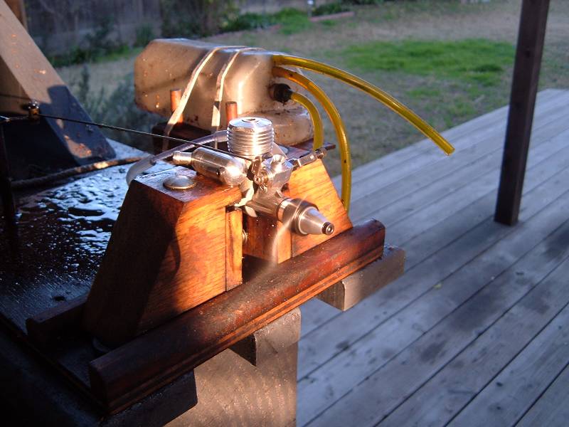

Rocket Rob, chevy43, skalliwag and myself bench ran one of the new CS .061 diesels a couple of weeks ago. We all agreed that it was a good buy for $48 US. The brass contra needs no extra seal, has a tight fit in the aluminum head. The brass ends up nice and flush with the inside surface of the head when in the running position.

What size props did you run on it ? any No's ? also looking at the RH picture the head on yours is slightly different to mine, The thicker top fin on mine is full dia of the head and has flats cut on opposing sides for a spanner.

I don't remember the prop and RPM, maybe one of the other guys will chime in!
Mine had flats filed on the top fin, but they were badly made, so I turned them off on the lathe, just to make it easier to look at.

I can see the flats in the 1st photo you posted ...
That is a very nice looking little diesel and at $48 would be a good buy. Any comment on throttling with the R/C carb?

IMHO, this one throttles very nicely. Does not have an air bleed, but you will not miss it. Think of this engine as "the poor man's MP Jet".
I have the MP Jet .061 (1cc) R/C diesel and consider it the best small R/C diesel I have tried! In heaven, everyone will have one.
