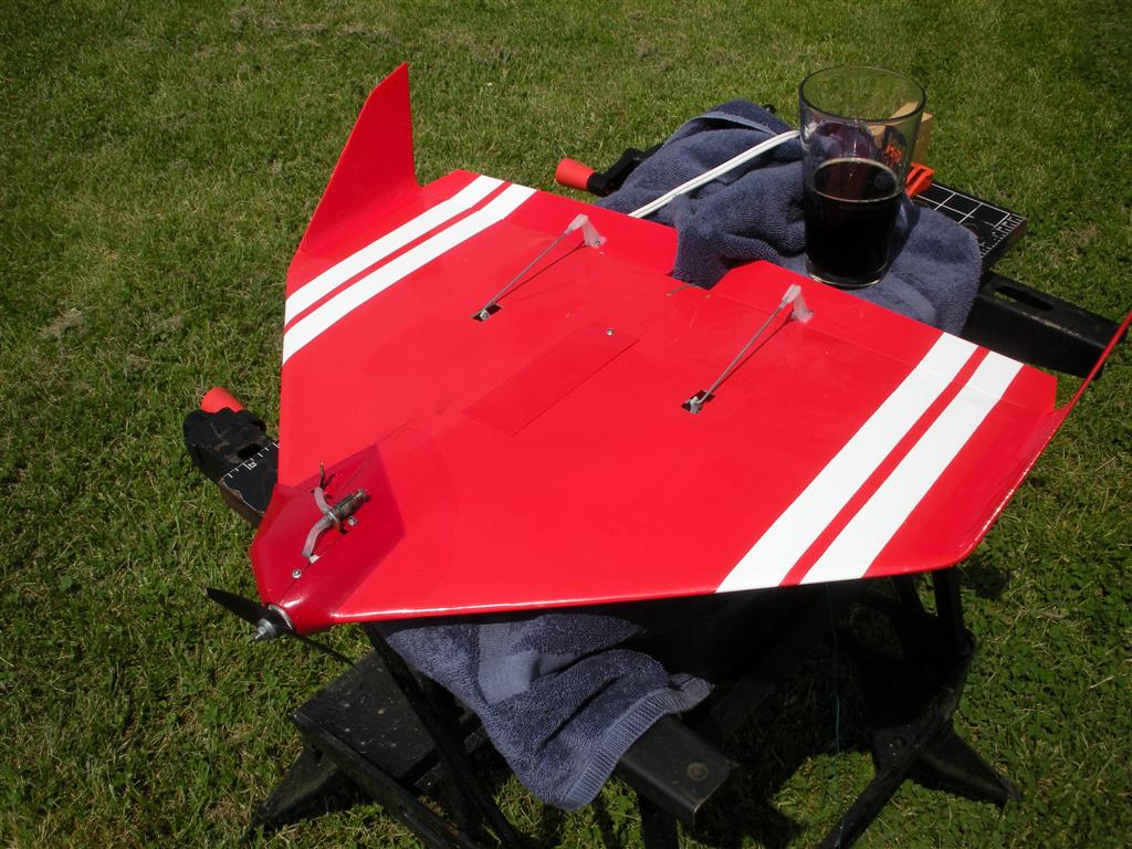

That's a great start to a speed project!
What I like about the smaller engines is the planes that they go in are twice as easy to build and twice as easy to build lightly with common materials.
