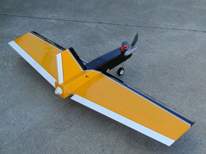

Pedro:
I forgot to thank you for the instrs. on how to post pics. Everything worked fine once I discovered which buttons to push. Pics were taken with an Olympus C2100, an AWESOME camera.
The plane is covered with UltraCote. Engine is a Magnum XL .46, and the prop is an APC 11-1/2 x 4. This setup provides unlimited vertical performance and a top speed in level flight between 50 and 60 mph.
The wing cores are from 2" blue building foam. The cone on the rear of the fuse. is an old spinner with 4 oz. of lead shot - required to get the C.G. right (the plane was originally designed for a .21 engine).
The wing incidence HAS to be slightly positive when sitting on the gear, or the plane will NOT rotate for takeoff. In flight it is extremely stabile and large loops require no aileron correction. Landings are a joy, with a quite high angle of attack at touchdown, and the elevons are responsive right down to stall making the plane very controllable at slow speeds. Roll rate on high aileron rate is so fast you can't count 'em, but on low rate with a little expotential added it's extremely docile. Inverted flight takes a moderate amount of elevator, but otherwise it flies just as good inverted as right side up.
The only "negative" to this design has to be the fact that (with no rudder) it is somewhat limited as to what aerobatics it will perform.
Frothingslosh
Frothingslosh

Paul -
I didn't add rudder (yaw) control because I wasn't comfortable with the way I would have had to route the controls. Had planned on rudder control from the time I started building it, but scrapped the plan at the last minute in favor of a roomier and more uncluttered fuse. interior.
Mine will sit on the tail also if you raise the nose, but still wouldn't rotate till I added a little positive incidence.
Wonder if anyone has built a larger version, like maybe a 100" wingspan - should be impressive and a real blast to fly.
Dick
Dick

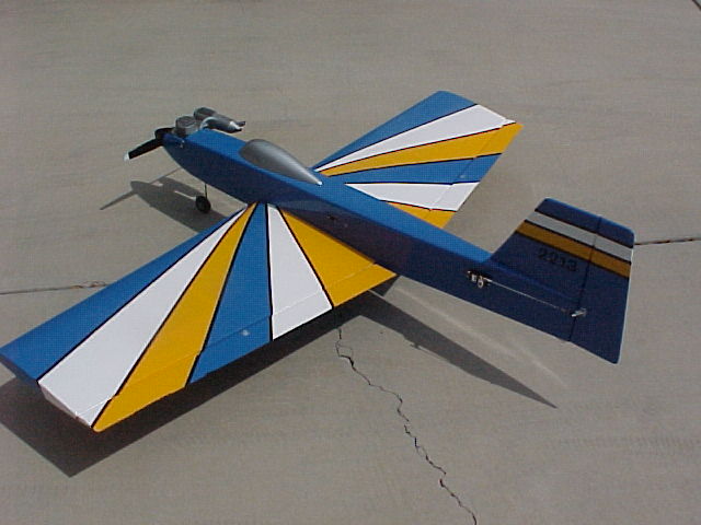

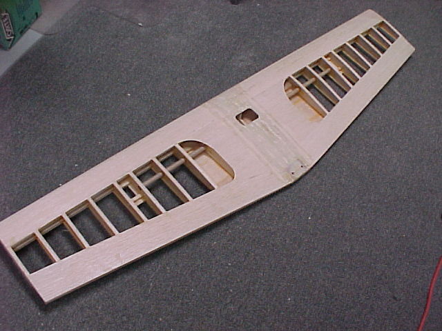

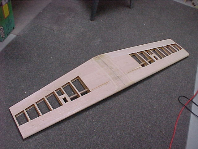

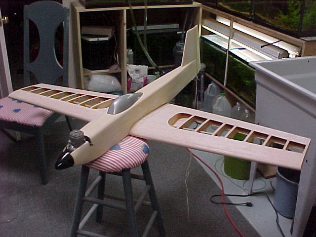

Thought that the following might be of interest to all Simitar builders/flyers. I got a phone call from Bill Evans yesterday and he advised me that the C.G. for ALL simitars is calculated to be 10 percent of the total chord at the wing root. (This INCLUDES the elevon chord as well as the wing itself!). So if your wing measures 15 inches from the L.E. to the elevon T.E. the balance point should be 1 1/2 inches aft of the L.E. Good thing I got this info as my "Trots" balanced at 3 inches before I adjusted the C.G. by relocating the flight pack battery forward so the C.G. is now 1 7/16 inches aft of the L.E. (The total chord of my "Trots" is 14 inches). Bill did not read the Simitar thread, but did respond to my e-mail to him. So, if you need any info from him, best to e-mail him at: [email protected] Incidentally, you can still order Tracer wing cores, balsa and formed landing gear struts from him. I don't know if he has short kit supplies for his other Simitar designs, but I'm sure there is a good chance he does. Anyway, an e-mail to him will let you know.
Flew the "Trots" a couple of days ago with the CG 1.4 inches aft of the leading edge. Flies great! Is a bit underpowered with a MECOA .46 and plan on retrofitting in a MDDS .49 with a tuned pipe muffler. Should really honk then.
Have just finished my "Tracer 60" with a built-up wing in lieu of the original foam core/sheeted skin wing that the design calls for. Reason for this was that I already had the needed balsa/plywwod and I felt that installing two elevon servos midway outboard in the wing would
be easier in a built-up structure. See attached pictures which now include the almost ready-to-fly model. Interestingly enough, the "Tracer 60" came out a bit nose-heavy and I had to mount the rudder servo in the aft part of the fuselage to get the CG where it belongs.
Dead Stick Dave[image

Very interested in your Tracer 60 with the built up wing. Do you have plans for the wing or maybe some templates? Did you use the airfoil used in the plans? The constructions looks very robust.
RCFAN
RCFAN
#47
Joined: Dec 2002
Posts: 99
From: Albuquerque,
NM
Hi RC Fan,
I built my Simitar from plans obtained from R/C Modeler Plans Service. I used the plans outline of the wing and traced the airfoils on 3/32 inch sheet balsa from the drawings of the root and tips shown on the side view of the model. Then, I made a "D" type leading edge with 3/32 x 2 inch sheet balsa and 1/4 square bass spars. The "V" type trailing edge consisted of upper/lower 3/32 x 2 inch sheet balsa. Ribs were capstripped 1/4 x 3/32 strip balsa. Result was a very robust yet light structure. I contacted Bill Evans and he approved of this approach in lieu of the original sheet covered foam wing called out in the plans. Hope this will help you out!
Dave
Dave

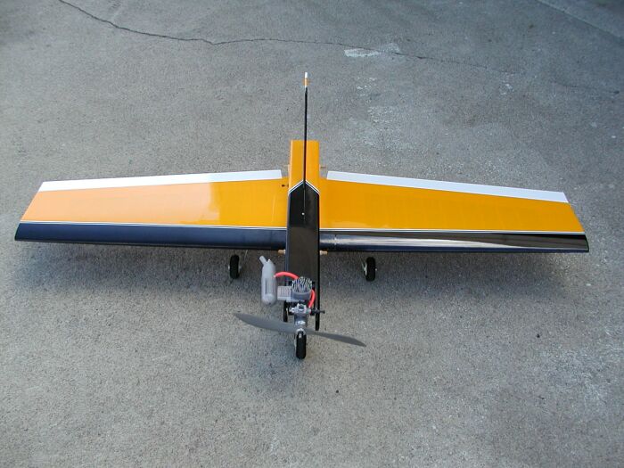

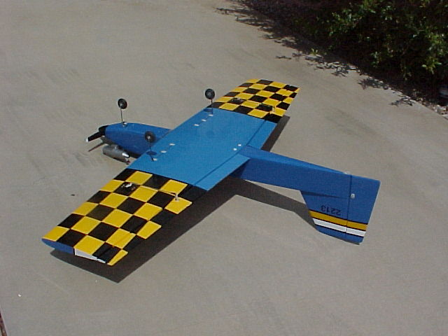

I have been flying Bill Evans designs for many years now. I have modified the airfoil platform thru trial and error and came up with something that looks very aggressive and actually improves the flight performance. I put a slight total wing positive dihedral (about 12 degrees) and on each wingtip I put a slight down dihedral (about the same 12 degrees). The outer wing portion that has negative dihedral is at the point of 15% to 17% of the total wing half length. See the attached pictures of my flying squadron.
[img][/image
[img][/image
