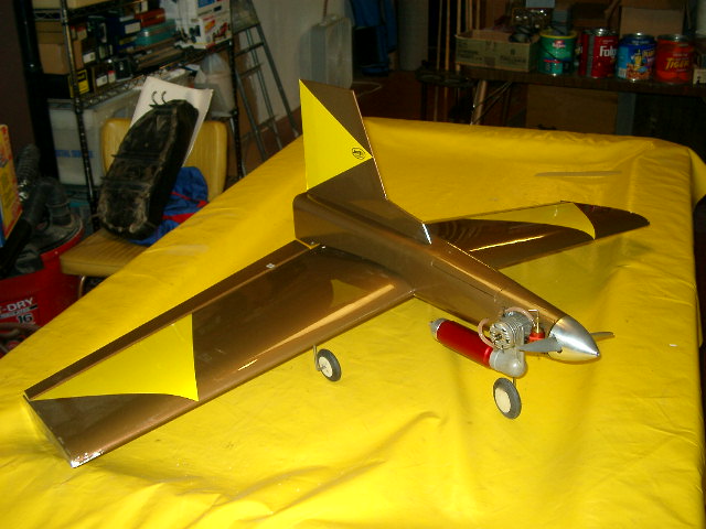

The Desperado wings are 25 inches long, for each half wing. They recommend a 2.0 inch anhedral. I built mine that way, and it is VERY VERY difficult to understand the orientation of the airplane. The short fuselage, and the anhedral make it look like it's inverted. You can also build it flat or with some dihedral.
It has Jett 50 with a 9x8 APC prop, and it is VERY FAST.

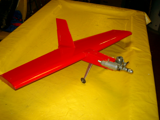

The 1/2A Scimitar is 24 inches long, each half wing, and has a 1 1/8 inch dihedral for each tip.
I built this 1/2 A , but I cut 4 inches off each root before I joined them. It was too slow with an .09, so I extended the nose and put in an OS 32 FSR. It's fast now, but it doesn't glide at all.

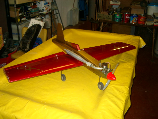

I also have a Shooter, which is my junk airplane. It has a piped Rossi 45 and it's fairly fast.

Here is a pic of the Desperado

Here's my Shooter

Here's my 1/2 A Scimitar

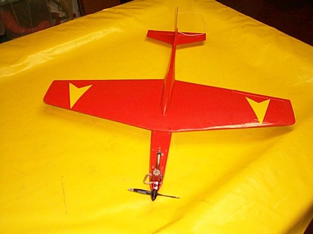

Here's my Taperwing

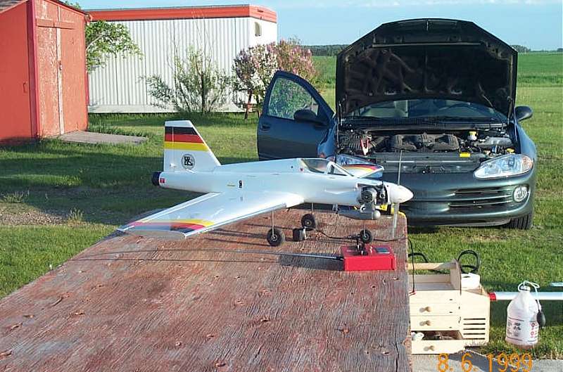

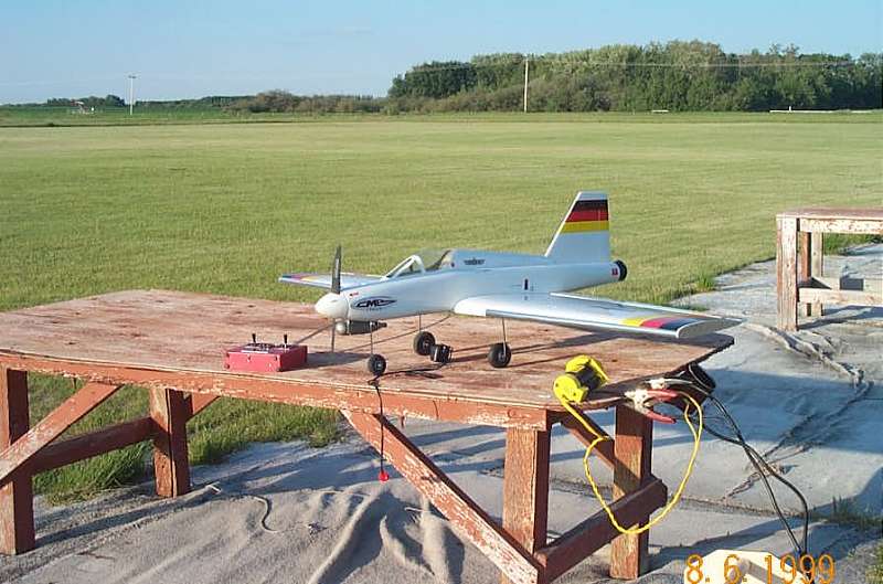

Good Evening Everyone
I have many of Bill Evans plans in the 8.5 x 11 size. I also have the Simitar 540 full size plans.
As well I have plans of my own.
Attached is a photo of a modified Bill Evans with an ASP 91. This is a super flying airplane. It will leap off the ground when full throttle applied and continue climbing. It is one of the better flying wings for upright and inverted spins.
I have built and flown many forward swept wings. I find them very stable and very aerobatic.
